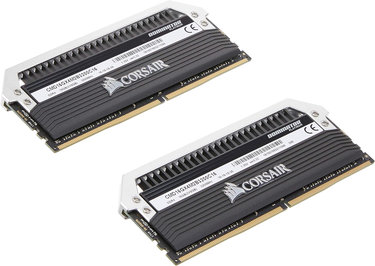

Hi all - I’d like to confirm that the Corsair Dominator Platinum 16GB Kit (2x 8GB) at 3200MT/s v4.24 sticks work flawlessly on this mobo. I added 2x sticks for 32GB and it booted into XMP straight away.
CMD16GX4M2B3200C16
https://www.amazon.com/Corsair-Dominator-Platinum-3200MHz-PC4-25600/dp/B018GK2G9S

Having set VCORE SOC to 1.125vdc, CPU Core voltage to 1.4vdc, both DDR4 Channel Voltages to 1.4vdc, I’m only able to get a stable 2933MT/s OC on the Corsair sticks. Guess the v4.24 kit are not B-die after all.

Seems the ‘flawless’ boot up at 3200MT/s was a fluke. I can’t get it to do it again…

Thought I’d post my progress in overclocking the Corsair Dominator Platinum DDR4 RAM (CMD16GX4M2B3200C16) - I’ve included a link to Amazon.
It took a lot more work getting these to run stable at 3200 MT/s given that the RAM I received are v4.24 E-die. Here’s the config that worked for me -
  • Threadripper 1950X
  • Gigabyte X399 Aorus Gaming 7 (UEFI f3g)
  • Corsair Dominator Plat v4.24 CMD16GX4M2B3200C16 x2 = 32GB
CPU VCore 1.4vdc
VCore SOC 1.125vdc
DRAM Channel 1.48vdc
XMP - disabled
Memory manually set to 3200 MT/s
Timings manually set to 16-18-18-18-36
I noticed in the UEFI the DRAM Channel voltage does fluctuate and touch 1.5vdc. It’s good that I didn’t set it to 1.5vdc directly, as that may have pushed a bit too much through the RAM.
XMP had to be turned off; with XMP I just cannot get it to POST - it may be lowering the voltage, although I’m not sure.
