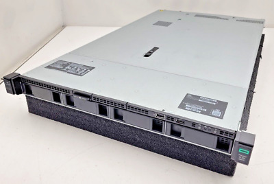

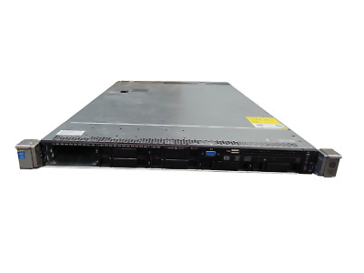

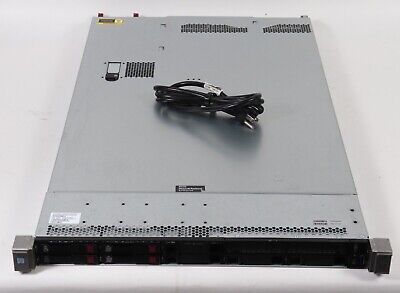

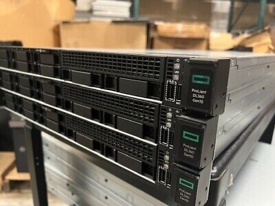

Could be wrong, but it appears as though they are using the same chassis based on images comparing screw holes, lack of physical feature changes (none except sockets), and lack of any other visual change. Heres the ones I compared. Feel free to look for more sold ebay listings to get a good look at things and compare em. You can also check the system and board manuals to check exact screw hole placement, but I am lazy lol.
360 g10
360 g9

I think the G10 board will bolt directly into the G9 chassis. Risers are perhaps a different story.
