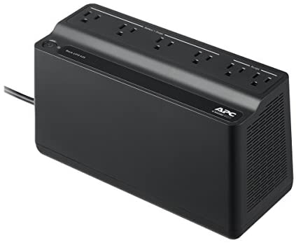

Is the ups I run tho
My upstairs tv uses this
