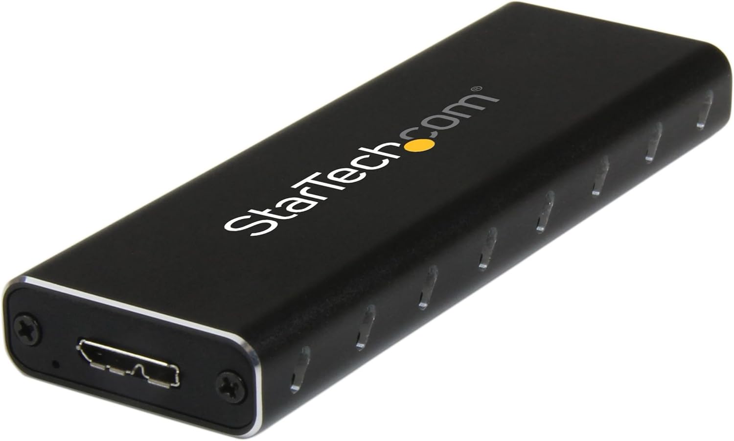

I have a 500GB USB M.2 enclosure that’s got a few different distros installed on it. Really helps for when I run into similar issues.
Yeah, I need to set something like that up. Right now I have a keychain with about 20 flash drives on it that are labelled. They’re mostly install media though and not bootable OS’s.
Do you just have a bunch of boot entries in GRUB or do you manage it another way?
Grub will chainload an ISO. Super convenient
Yeah, it’s a bunch of ISOs and a couple installed environments (Kali, Lubuntu 14.04)
$110 for a solid solution.
