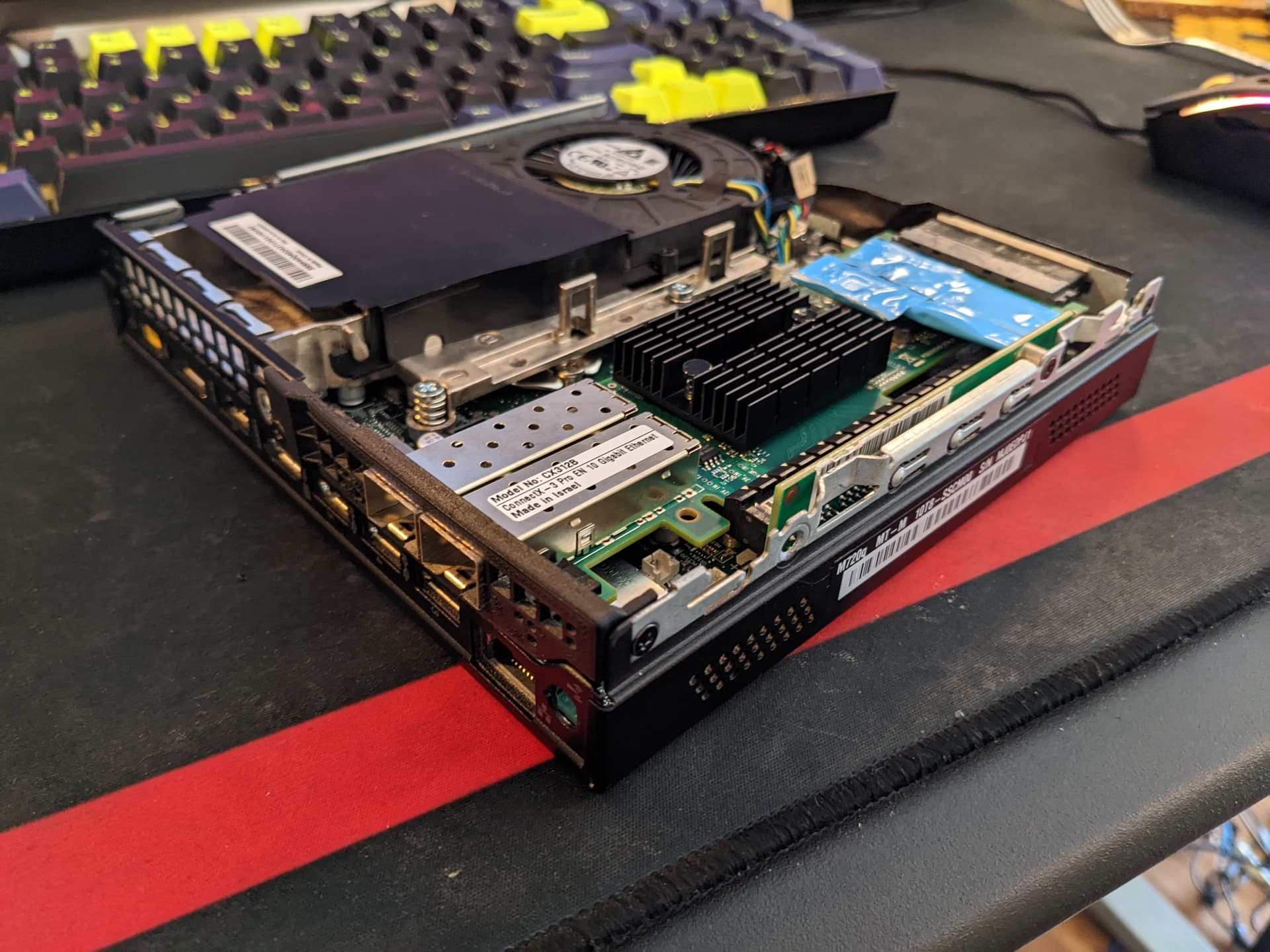

Dual 10gb SFP w/ 8x PCIe 3.0 on a 16x slot in a M720Q, I expect this will be more than enough bandwidth for such a little PC.

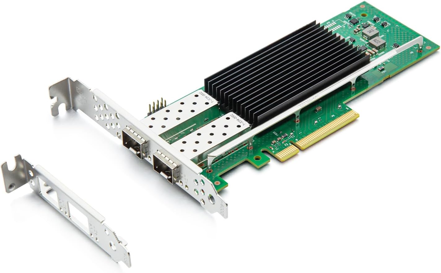

ConnectX4s are cheapish these days. I just bought 2 within the past 6 months. I’m only using them for 10 Gig but they are actually faster then the Intel X520s they replaced even at those speeds.
I bough a XXV710-DA1 card to fit into a x4 pci-e slot on my motherboard. It was the only available very bottom slot. Took a change if it will work, since card itself is x8, and it did. There is another version of this card XXV710-DA2 with two SFP28 slots with same 8x pci-e connector. So I figured, XXV710-DA1 must just use x4 lanes. Works perfect under Windows or ESXi.
Here is an eBay link: XXV710-DA1 XXV710DA1 INTEL XXV710 1-PORT 25GB SFP28 PCIE NETWORK ADAPTER | eBay
Mellanox CX4121A IBM 01GR253 Dual-Port SFP28 PCIe x8 3.0 25GbE Adapter FP
i bought this one of Ebay and it works just fine in my Unraid server.
I use one Port for my own LAN and one Port for my Grandparents LAN for PLEX
Flash-forward a few more months and there are Intel E810 options that are getting affordable too. I just ordered one of these for $229 for a new AM5 build I’m putting together:
I believe that’s an E810-XXVDA2 which is an x8 device running at PCIe 4.0 speed, more than sufficient for the two SFP28 slots.
I’ve currently got a Mellanox ConnectX-4 LX in slot with only x4 lanes running at PCIe 3.0 speed through the chipset on my x570 Gigabyte motherboard. So while it’s faster than the 10Gb interface I had before, it’s still bottlenecked by my configuration.
