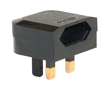

One thing though is that the plug is a two-prong that goes into a three-prong converter and the ground pin is plastic (just like in the image).
I sort of doubt this is the issue though as it’s always been like this.
