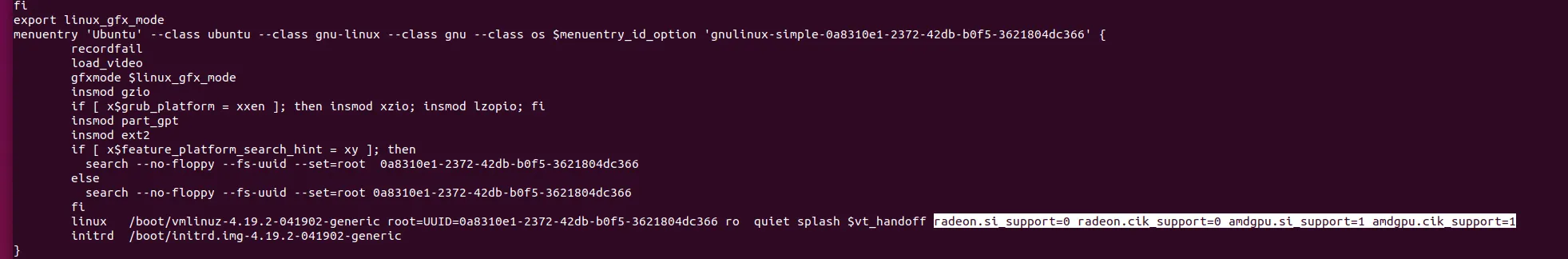

OK some from what I read AMDGPU isn’t enabled by default on your card as it is still listed as experimental although according to this article:
It looks stable enough to try. You have to add “radeon.si_support=0 radeon.cik_support=0” kernel module parameter at boot to enable AMDGPU driver on your card. This should help with the performance of your graphics and it seems that AMD is actively working to get support with your card.
If you want to upgrade your card then no problems just do it - but if you are happy with the performance of your current card then you might want to try this first.
#edit: I see someone on the forum has been through this:
GRUB_CMDLINE_LINUX_DEFAULT=“radeon.si_support=0 amdgpu.si_support=1 radeon.cik_support=0 amdgpu.cik_support=1 rd.driver.blacklist=radeon quiet”
I added the above to grub
did ‘sudo update-grub’ and got the following error:
simon@UD5:~$ sudo update-grub
/usr/sbin/grub-mkconfig: 12: /etc/default/grub: amdgpu.si_support=1: not found
I will keep trying.
Right I think is now working
02:00.0 VGA compatible controller [0300]: Advanced Micro Devices, Inc. [AMD/ATI] Tahiti XT [Radeon HD 7970/8970 OEM / R9 280X] [1002:6798]
Subsystem: Hightech Information System Ltd. HD 7970 IceQ X² [1787:201c]
Kernel driver in use: amdgpu
Kernel modules: radeon, amdgpu
Before the Kernel driver in use was radeon
This was the correction made in the grub.cfg
GRUB_CMDLINE_LINUX=“radeon.si_support=0 radeon.cik_support=0 amdgpu.si_support=1 amdgpu.cik_support=1 radeon.modeset=0”
sudo update-grub, reboot and bob’s your uncle, kernel driver in use is amdgpu
I will download CS:GO and test.
Edit: Under ubuntu details it has also changed.
