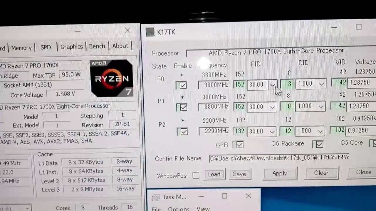

So I just setup my overclock and ran into the Asrock x370 15.5x and 22x bug; which was locking my cores to 1.5ghz when trying to overclock to 3.8ghz using a 1.35 vcore.
Someone linked this guy’s video showing a workaround and sure enough, his workaround worked.
My cinebench score is 1675cb @ 3.8ghz - 1.35 voltage. I’m going to Run Prime95 for an hour for a stability check and I’ll report back on that as well.
