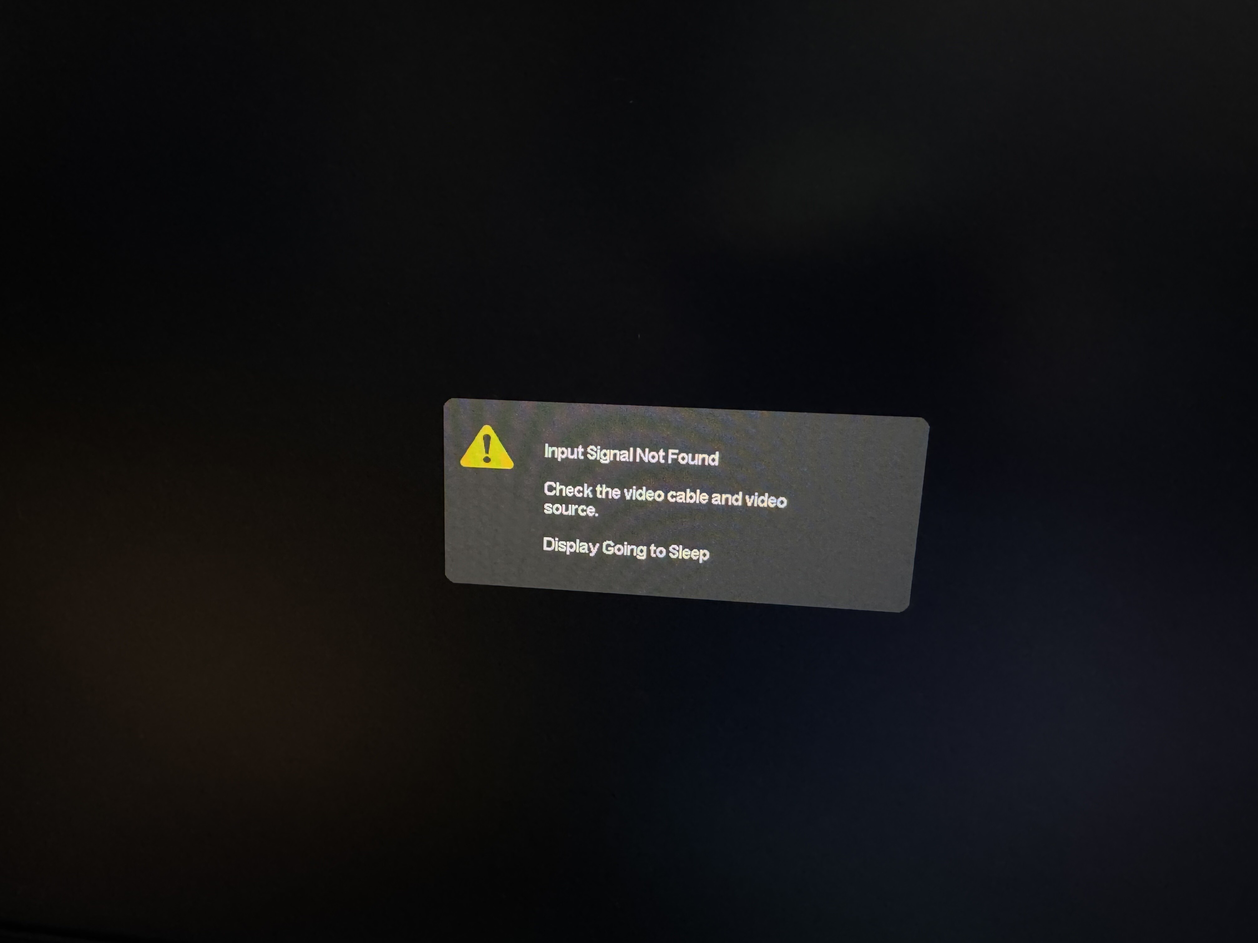

Okay I just hooked up the VGA monitor and still no input signal, I think i need to update the bios but there is no way to boot into bios or ipmi to run the update…

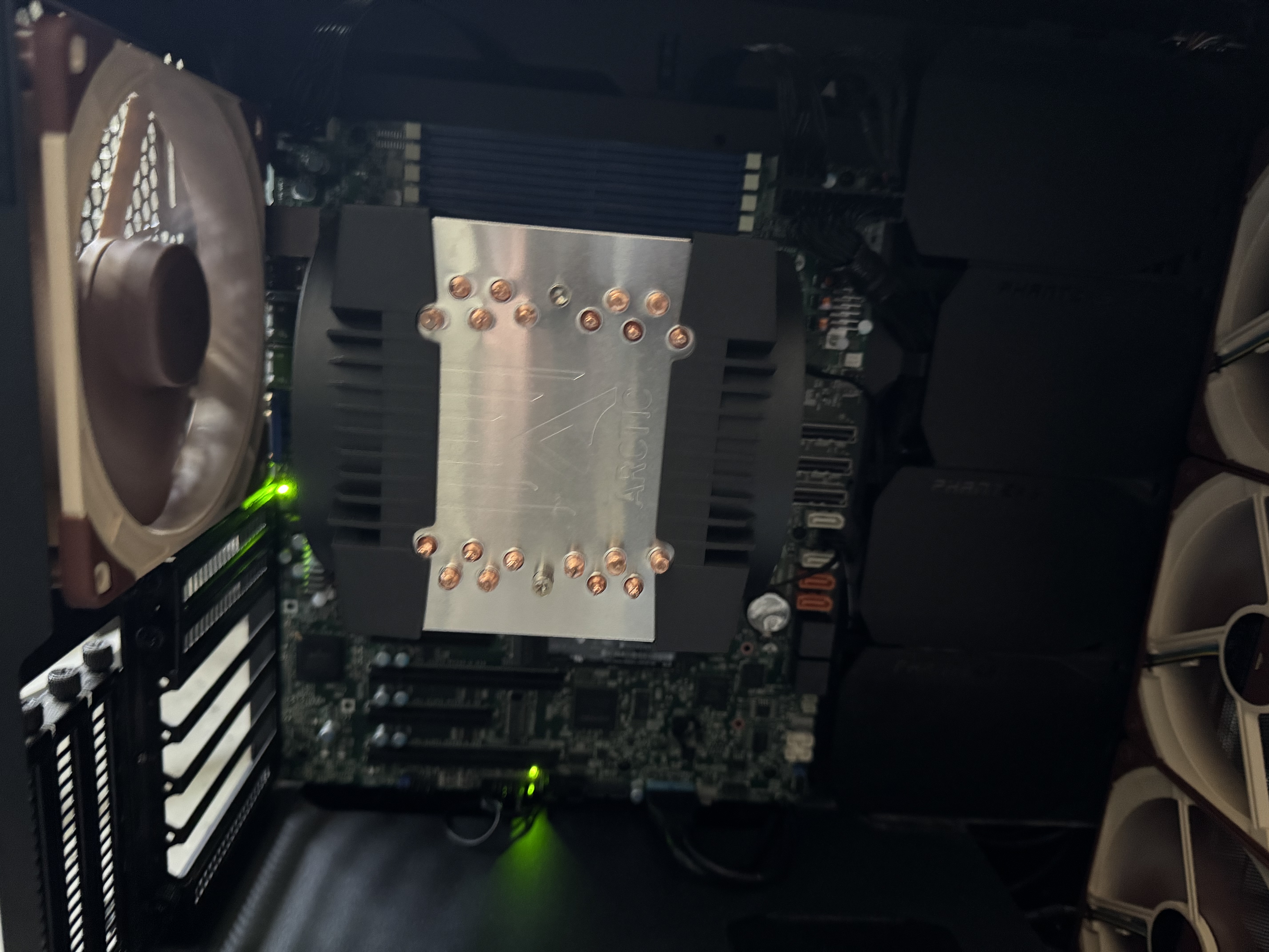

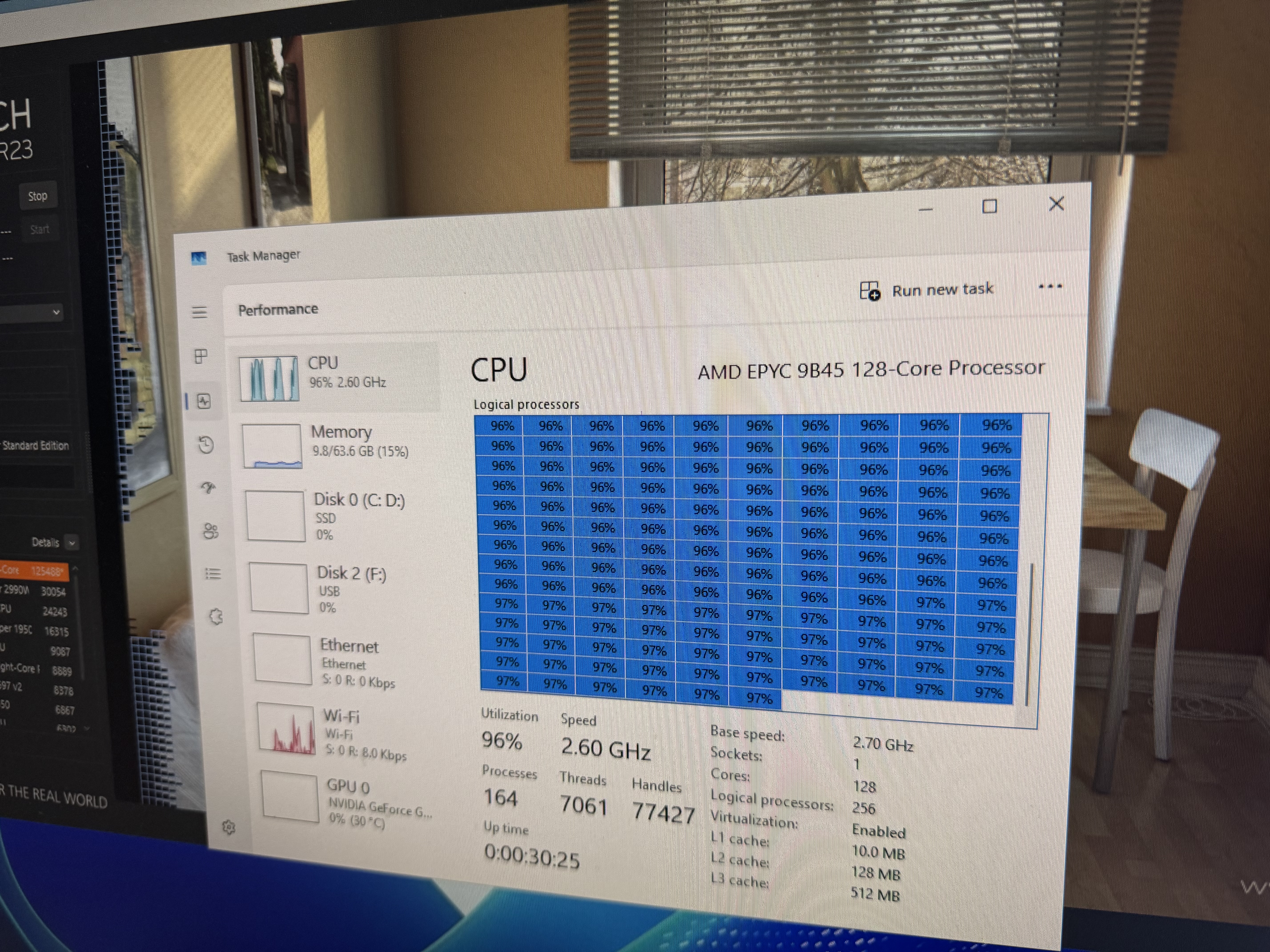

So I tried everything… from connecting to the ipmi mode, its already on latest version of bios. Reached out to Supermicro technical support and then I decided to remove heatsink to check on the cpu, but its stuck to the cpu and not even budge no matter how hard I tried to yank it out. So I looked up how to remove the heatsink and found out I never tightened the 2 top screws on the heatsink, so I tightened all the screws again and … voila IT BOOTED UP! I tried to install Win 10,11 iot ltsc and only Windows Server 2025 came though, I also found out the wifi pcie card is garbage both wifi 6e and 7 version. I plugged in my old wifi usb 4 and everything runs perfectly without installing anything extra. And is there any software that can track temperature, clock speed of the cpu. Because hwinfo and others dont really run on this os, only one works but only shows the utilization percentage of the cpu, and how can I hardcoded the fan speed to bios or best just software fan control to set it. I will update more on my progress when I receive more ram and gpu.

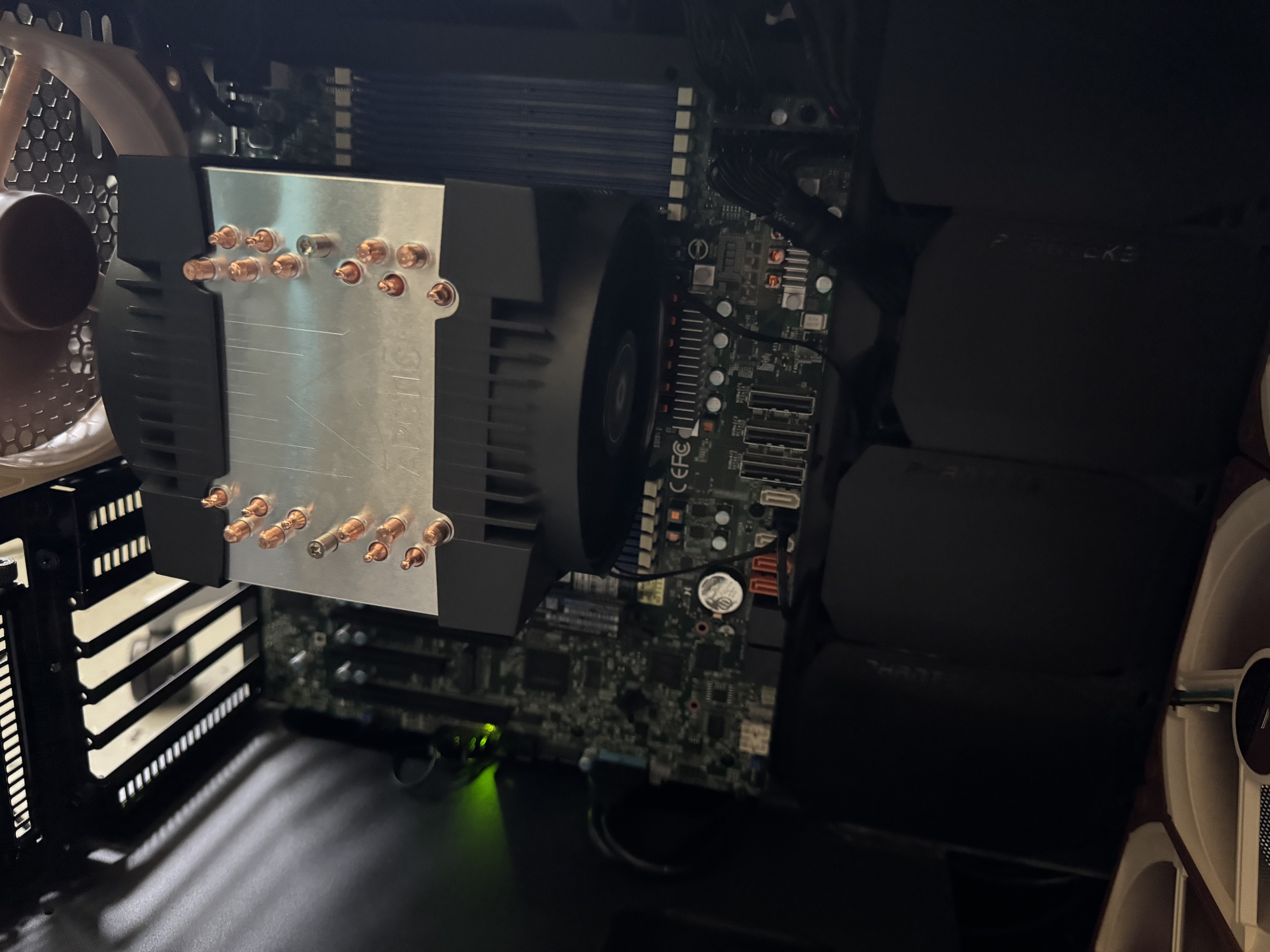

However, after 2 weeks, I still have the panic button on the CPU fan. It looks like you have the same Arctic fan. Did someone worked it out, how to prevent this fan oscillation?
