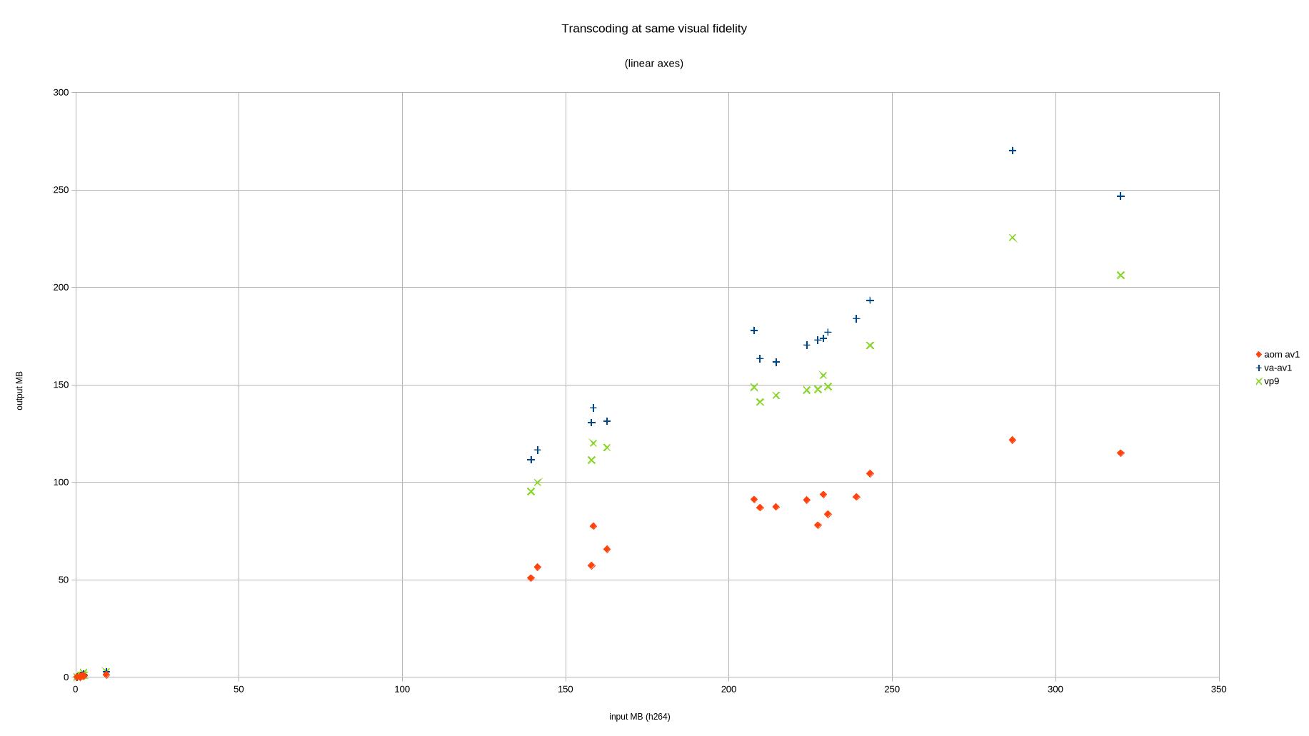

AMD AV1 worse than VP9? (actually better)
Here I’m transcoding videos from h.264 → {VP9, aomav1, va-av1}
The va-av1 is hardware accelerated with my 9070.
The rest are cpu.

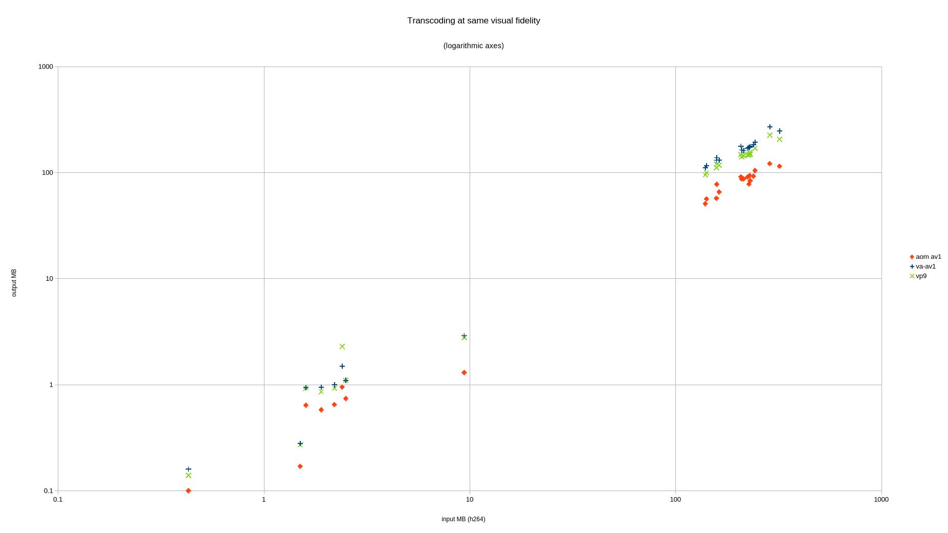

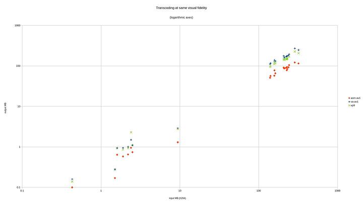

Here is the same graph but logarithmic axes to help with visibility on the smaller values.

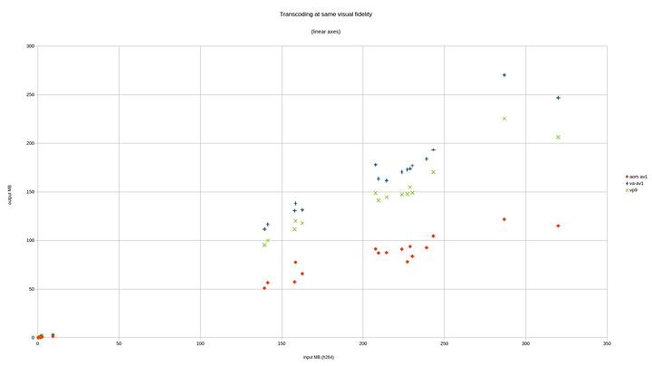

As you can see the va-av1 encoder produces larger files at the same visual fidelity. It is worse at compression compared to a cpu-based VP9.
I always thought that hardware encoding would be ~10% worse, not this bad.
Hopefully I’m wrong and I can get the almost aomav1 file size with 100x speed of the hardware encoder.
Hardware encoding is FAST, not good. If you want a “proper” file, use CPU. If you want it on the fly, in embedded systems or systems with no CPU to speak of or fast in general, GPU encoding “ASIC” is the way to go but you have to limit yourself to not always optimal presets.

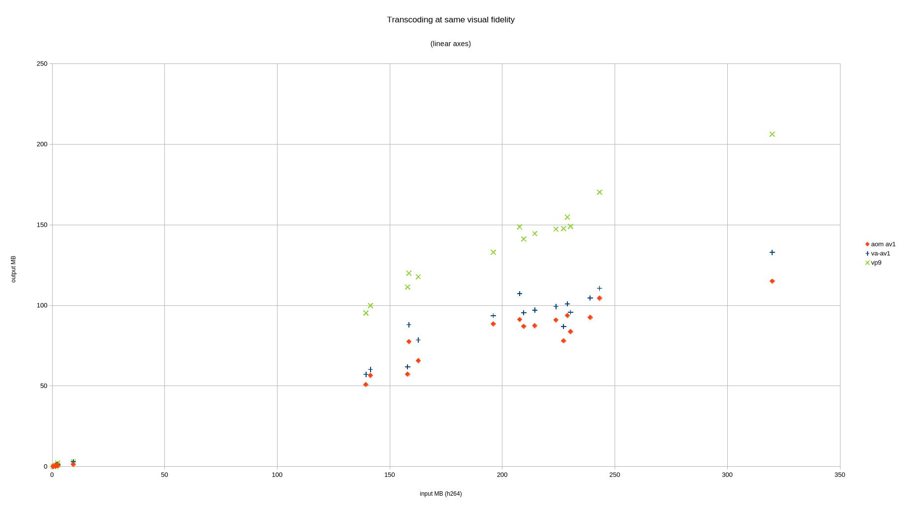

Good news everyone, good news!
(I didn’t re-compute the datapoints under 100MB, that’s why no log scale)

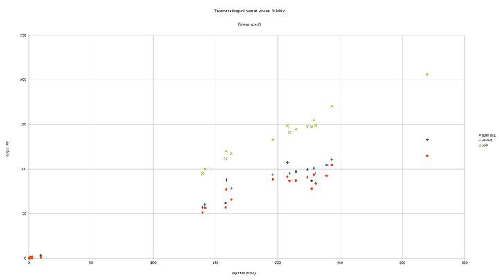

  1. There is a thing called gop_size that controls how often a frame is recomputed from zero. I don’t care about scrubbing performance, so I just set it at -g:v 10000000
  2. Compression level! -compression_level:v 29
So how does this compare now versus CPU encoding? I have always used my Threadripper to do CPU encoding, and I only use GPU encoding for gathering game clips quickly, or if I had to stream something.
It’s about 11% worse on average on the videos I tested.
If you look at the last picture I uploaded, the red rhombus is CPU, while the blue cross is GPU. GPU is consistently worse, but really close.
For my usecase GPU saves 99% of time and costs ~10% filesize. Sounds like a great trade.
Honestly, that’s not bad and definitely will work on most use cases.
