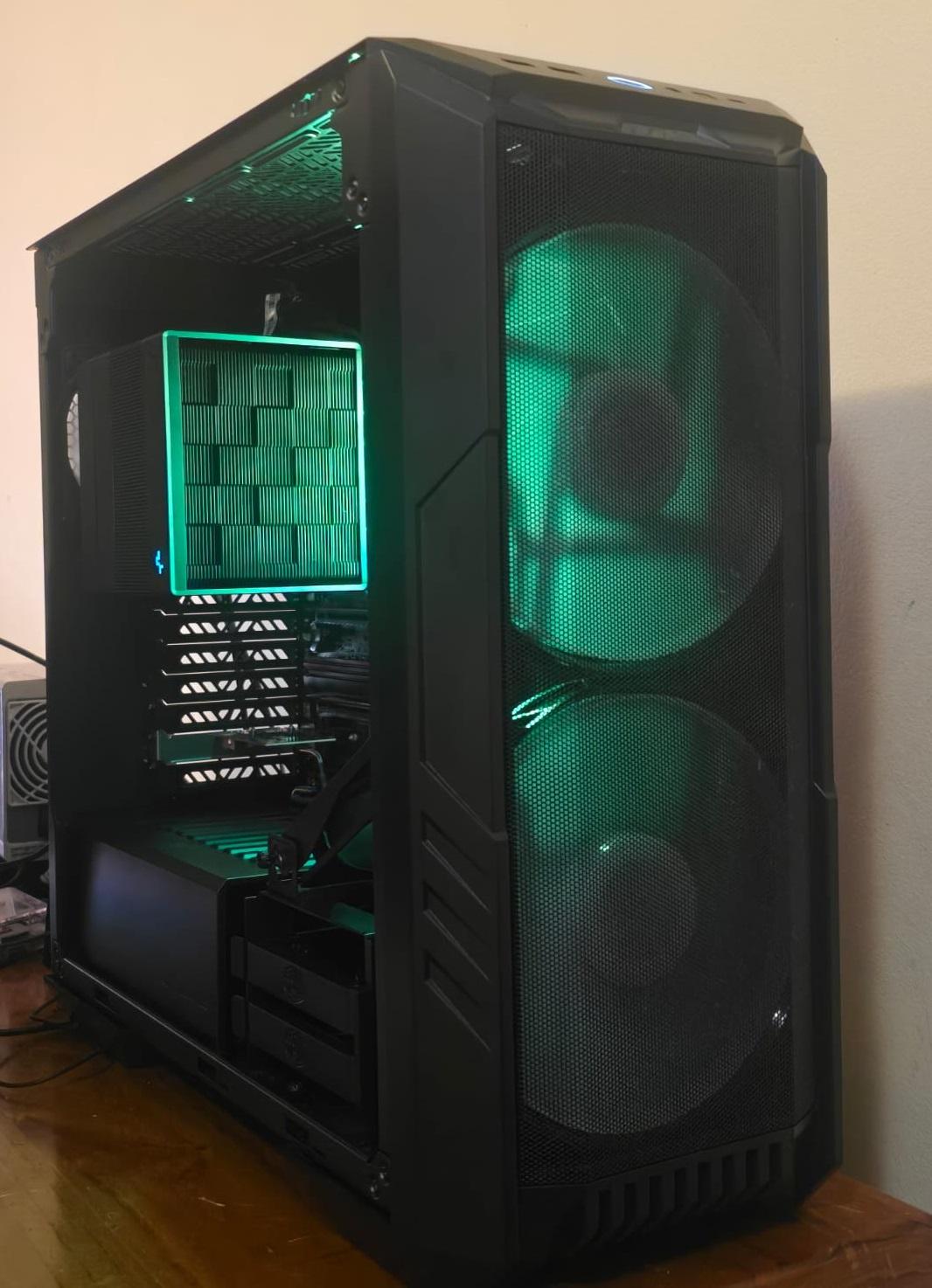

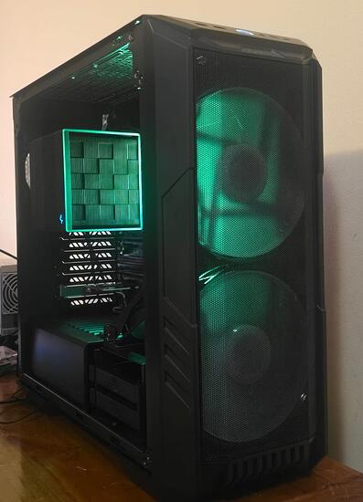

Here’s the completed build. No plans to overclock.
I got a deal on some Kingston RAM so thats what I got.
It seems the system is not stable for windows above 4200 MTs for windows. I have not tested personally; feedback from my IT supplier.
I think assumption is that the CPU speed is around 4200 Mhz so thats why they downgraded to 4200MTs for RAM…
I installed Proxmox and did bump up the RAM clock speed to 5000 MTs but ran into some issue which I cannot 100% attribute to the change in clock speed.
My main complaint is with the Asus BIOS its complicated to say the least since I am more used to HP and Dell bios from older systems which tend to me less complicated.
Still learning about XMP, CPU curve etc…
