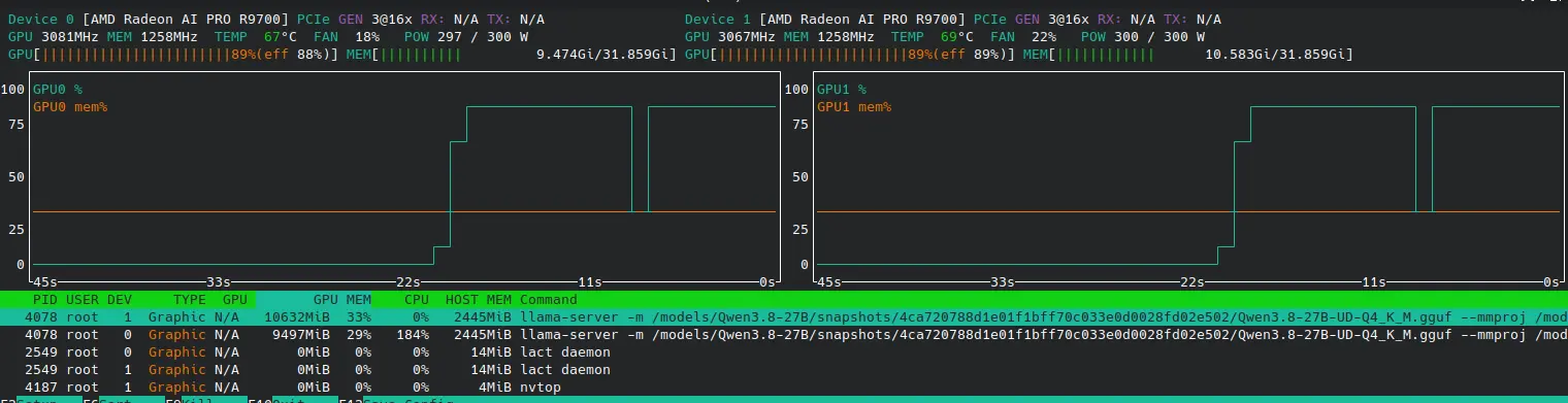

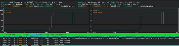

I have been doing some testing with latest llama.cpp build on ROCm and even on NVTOP.
I see the 300W being pulled during stable operation running Qwen3.8-27B-UD-Q4_K_M.gguf

I guess you are getting way less tok/s?
