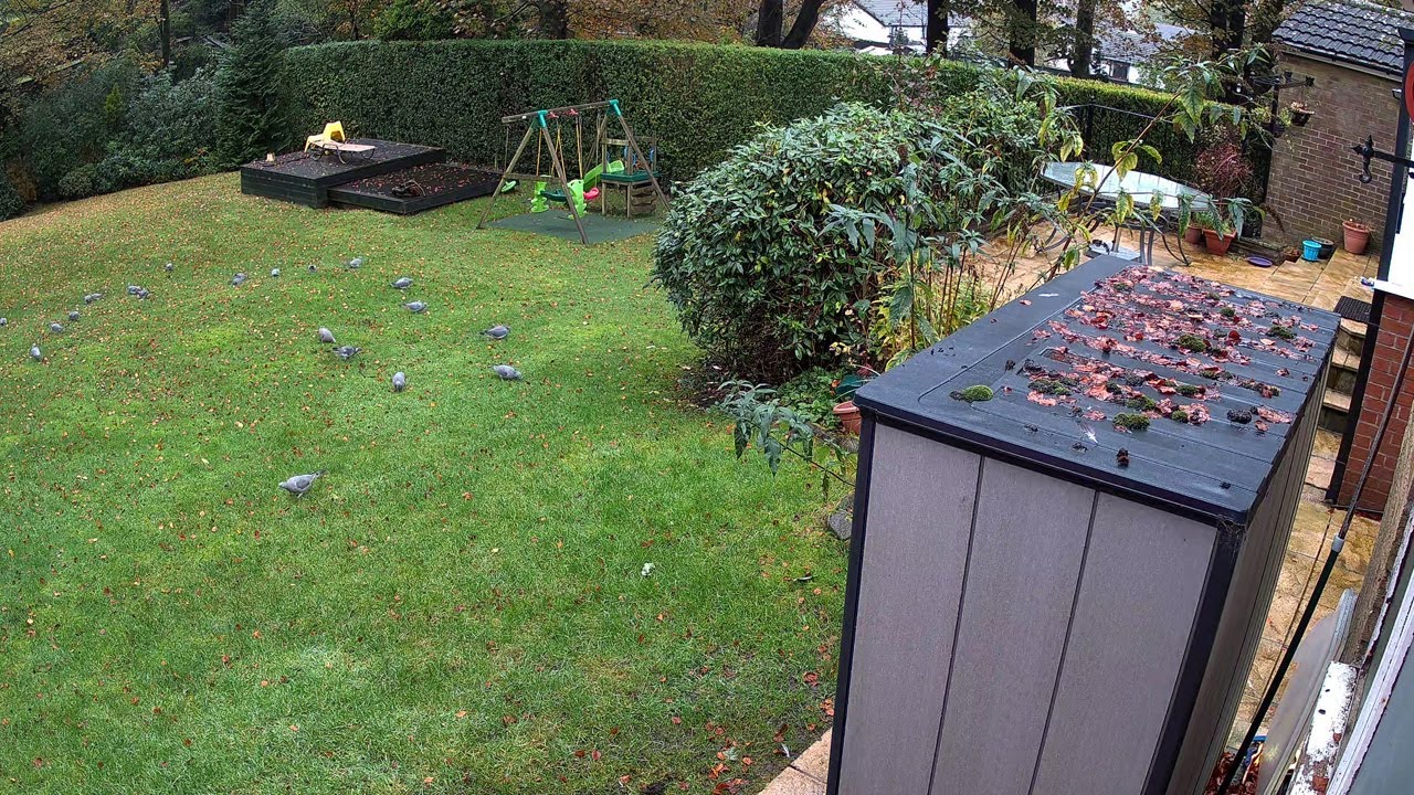

they have some samples
I don’t like the reolink stuff but it’s what I would recommend as well. As for 4k don’t bother good optics are always better than more pixels. Ptz and verifocal are the better value.
I’m learning they don’t have fantastic night vision
Starvis sensors and again good optics always win but the reolink stuff is a good compromise in price quality and ease of use.
What @infinitevalence said. The sensor is second to the optics. I have a ptz setup at my grandparents house that can read a license plate at 100 yards because it has good optics and zoom even though it is a 5mp sensor.
