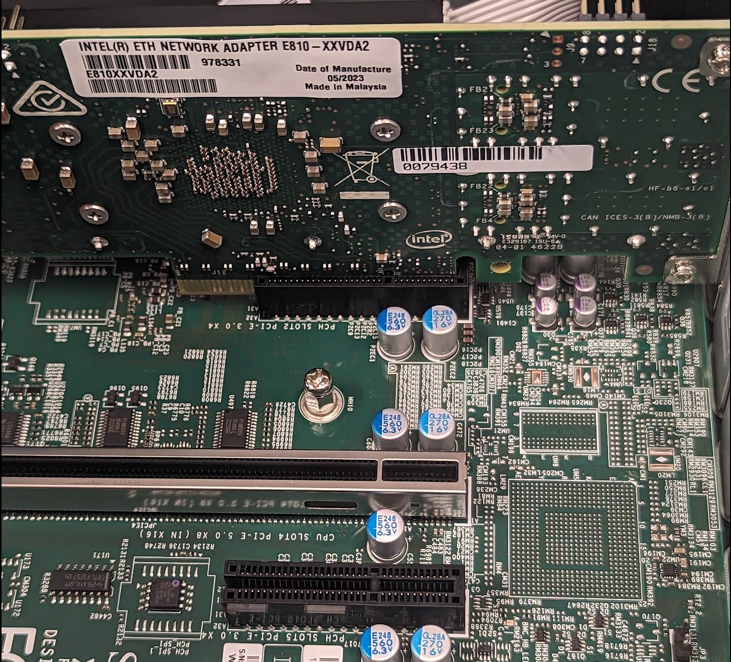

So far I have found this
€175 ebay - Intel E810-XXVDA2 - 2x sfp28 - x8 pcie 4.0
I am unsure how it performs at x4 but its reasonable to assume it will work since there’s enough bandwidth on x4 pcie 4
Reference here says it runs at full speed on x4 but its untested. I think I might try this one.

I have an Intel E810-XXV-2, works in Linux (Debian 12) and Windows 10 without hickups.
Running FS-branded SFP28-transceivers in there.
