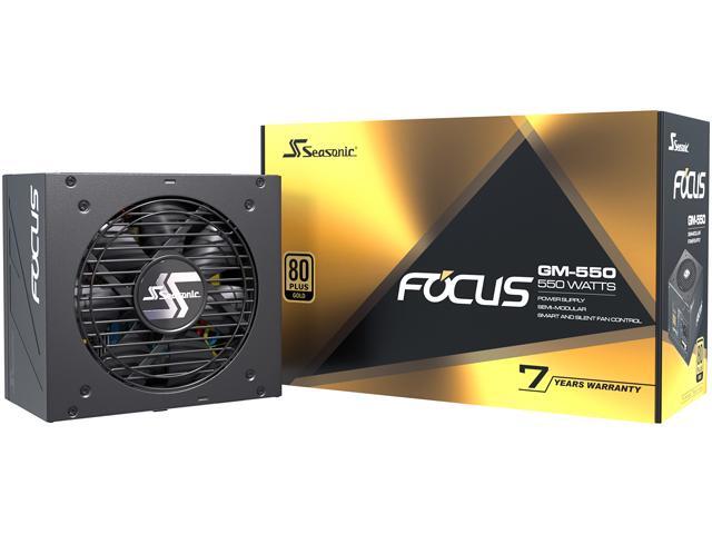

For a little bit more than this a Seasonic FOCUS Plus Platinum 550W is a great choice (10 year warranty)
Make that 80 and get a SeaSonic Focus SSR-550FM
Semi modular, 80+ Gold rated and 7 year warranty (not that it needs it)

And even the higher end aren’t that great, especially the Seasonic ones.
As said, the older X/P Series don’t work well with higher end GPUs such as x80ti nVidia Cards, VEGA and so on.
And the Focus also has some issues, for example with the ASUS GTX970 STRIX, Prime has some pretty shitty fans - not acceptable for THAT Price. Oh and lower end Prime ULTRA also use the FOCUS Plattform up to I think 650W…
And no, the Issues on the Focus are NOT fixed, because the Fix is to increase the OPP/OCP trip points - on a design that wasn’t designed for that, so now you have high ripple…
So no, “going Seasonic” is not that great, be quiet and Corsair are far better than Seasonic!

Jonnyguru review is saying that the Focus is exceptional though?
https://www.jonnyguru.com/blog/2017/09/18/seasonic-focus-plus-850-gold-power-supply/
And a quick look and it seems the Prime series is great as well.
Yes and they don’t test a ton of things such as fan noise and other stuff. Their Gear isn’t that great either (old SM-268 Load for example for the most part). And it also shows you that Reviews are just one part!!
And a PSU that can be tested really good can fail in the real world.
Jonnyguru also does not test overload/protections. That was tested. And it was before the “VEGA FIX”, wich was to increase the trip points of the protections, wich in turn leads to the above -> high ripple, for example due to Transformer Saturation…
Yes, it SEEMS but that doesn’t mean it is :wink:
But if it was as good as claimed, why are there people who had 5-6 Prime (ULTRA) because of fan noise? :wink:
The Issue is that Seasonic cheaped out on the fan and just used the Standard Hong Hua fan without any changes thus the fan has a rather annoying tickering…
And yes, there are some fans/PSU that have no noticable fan noise from other manufacturers…
