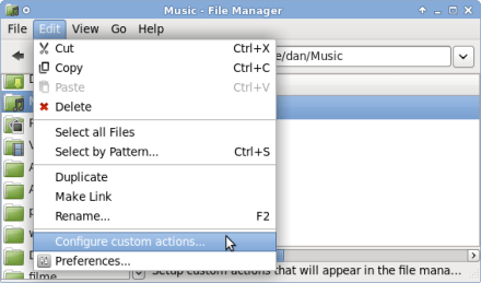

I was able to get it working using the Thunar file manager. I just used "smb://" and the file path
here is a walk through:
hope it helps
EDIT: sorry realized thats how to share a file using samba not access a file
