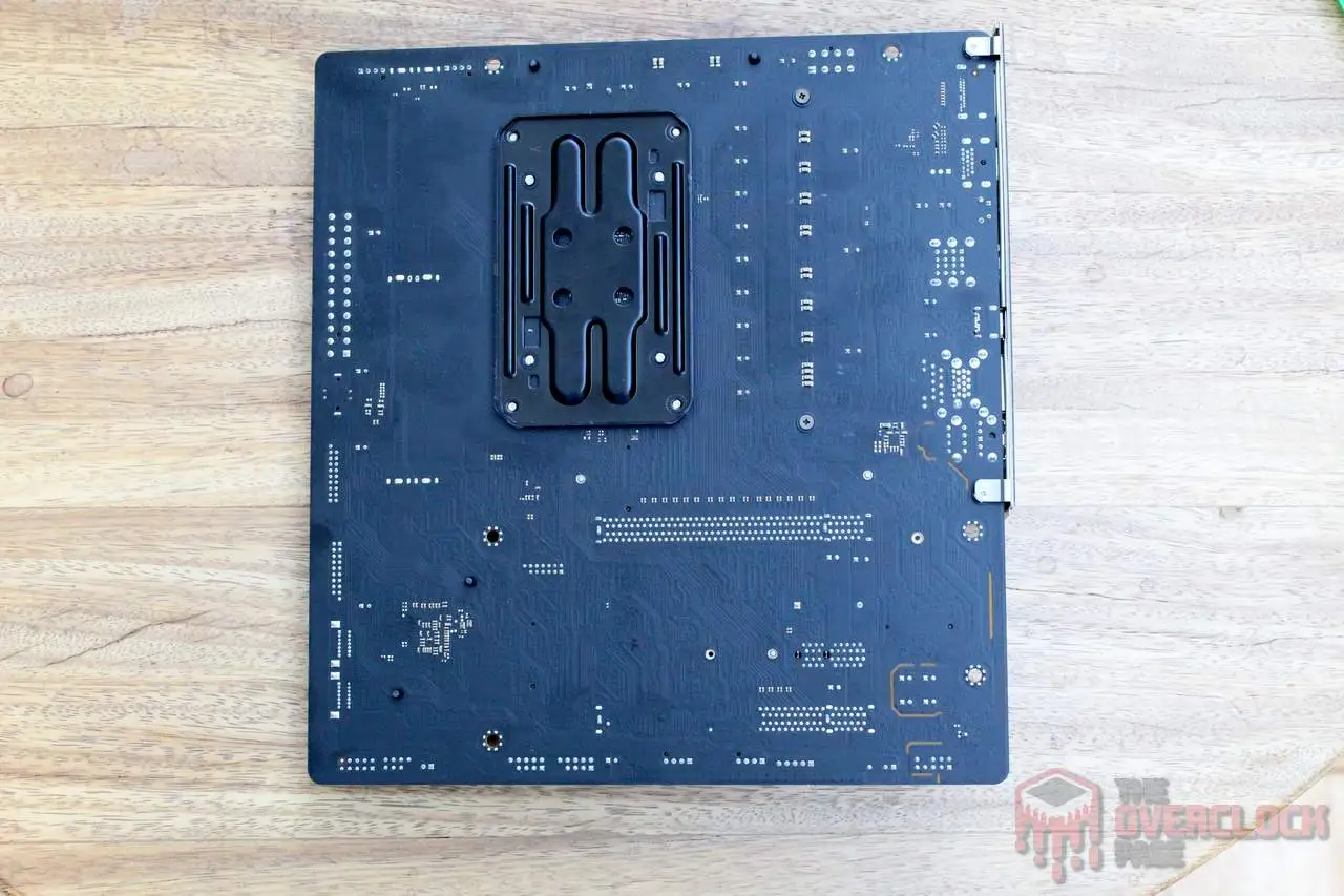

I realised I do have one AER-capable PCIe 4.0 x16 slot - in my ASRock B650M-HDV/M.2 motherboard of all places! The MB is so sparse on peripherals that four of the CPU lanes are actually routed to slot 5!
(Image stolen from The Overclock Page.)

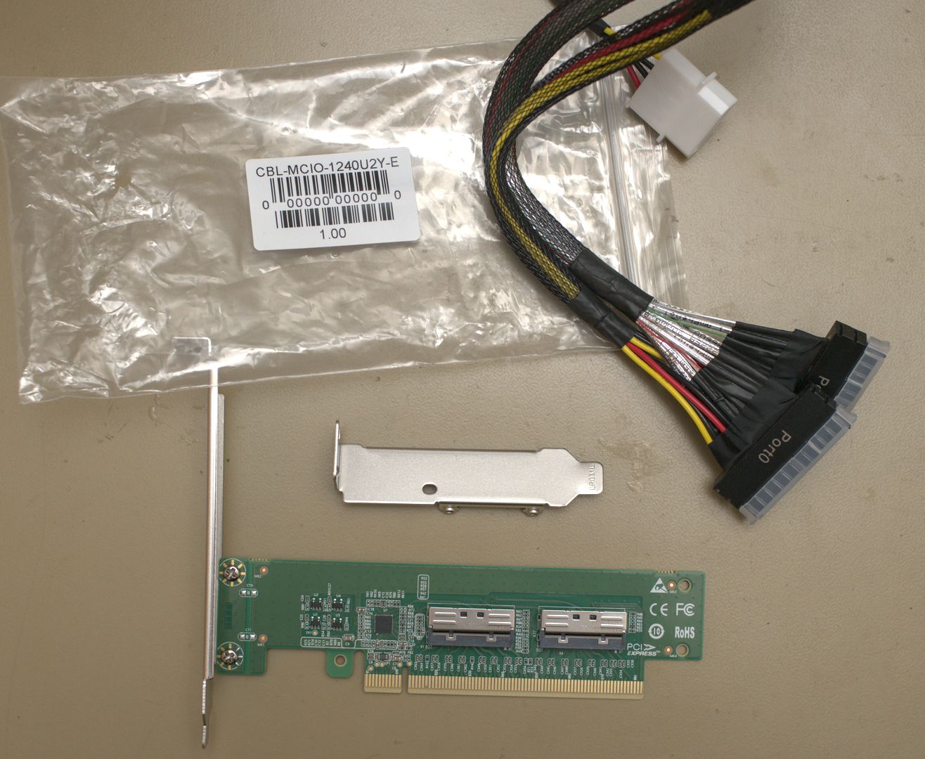

So I got that Kalea 2x MCIO card (via Ebay) and also a Supermicro CBL-MCIO-1240U2Y-E cable to try out:

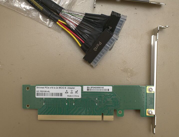

The card is really a “Shinreal PCIe x16 to 2x MCIO 8i Adapter”, “XIC PE5160-4IL”:

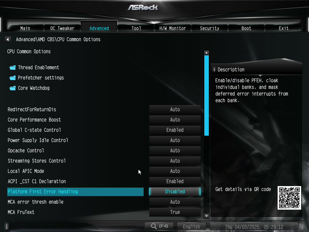

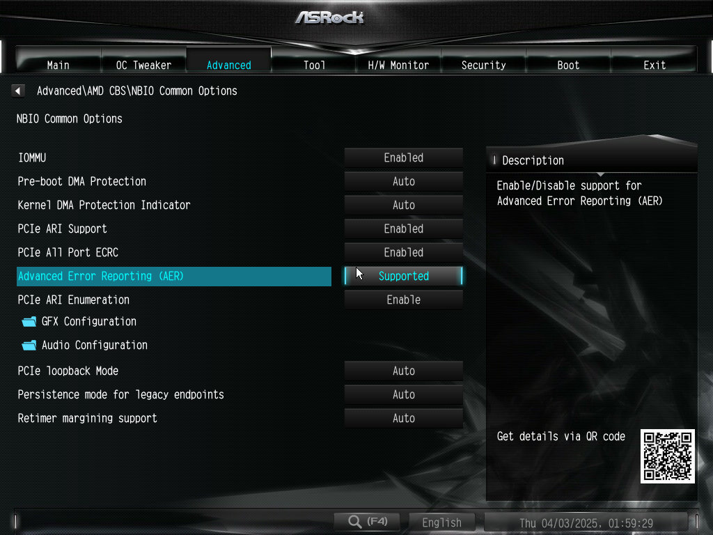

I made sure AER was enabled and PFEH disabled in UEFI:
… inserted the card and hooked my PCIe Gen3 P4610 U.2 drive up. I had to disable MB Thunderbolt support which apparently is via some optional add-on card meant to go into PCIE3 (where the card was). A thing that threw me off at first was that the Supermicro cable has the wrong markings - the first port is the one marked Port1 and the second is the one marked Port0! :facepalm: Disappointing; you should do better, Supermicro!
