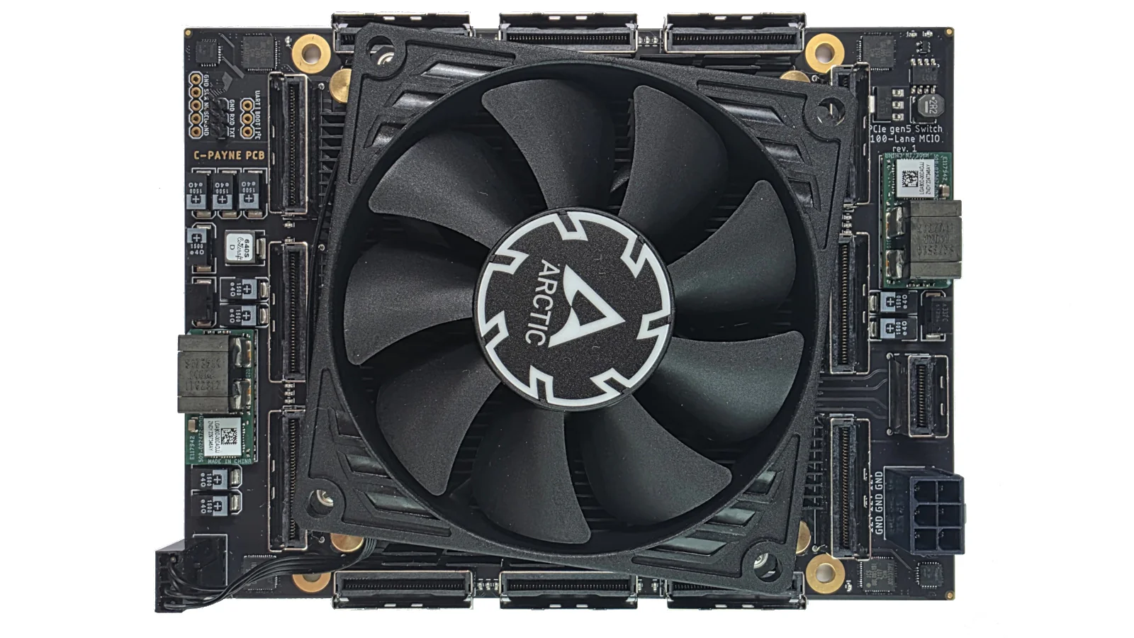

Been a while since I last spied anything new on the website. I spy a 100-lane PCIe 5.0 switch. :drooling_face:
PCIe gen5 MCIO Switch 100-Lane - Mircochip Switchtec PM50100

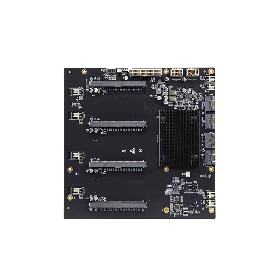

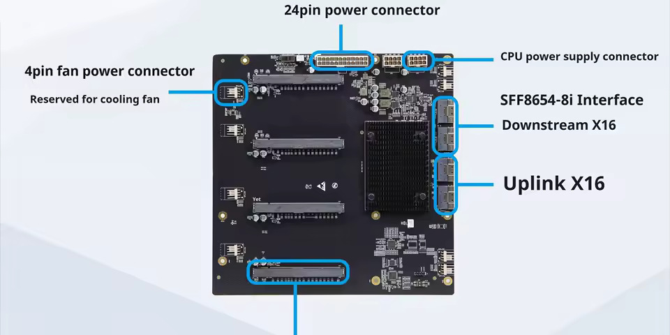

Unrelated reply: I just bought a pex board off ali express for $538 usd. Will hopefully be here in 4ish weeks, cant wait to try out gpu to gpu testing over it.
Anybody have one of these things? It appears to be a cheap wish.com alternative to fine german engineering of c-payne.
Let us know how it works! It would help a lot on consumer CPUs + Mobos that need more PCIe lanes, without sacrificing single core performance.

I am testing that 3-slot switch board right now for 500 bucks, significantly cheaper than the (probably higher quality) german version but… cheap.
I will try doing a 5x 3090 build with this and see if i can get it all working in the next few weeks, have a bunch going on at work and some other side projects to attend to as well though.

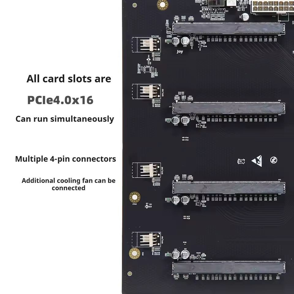

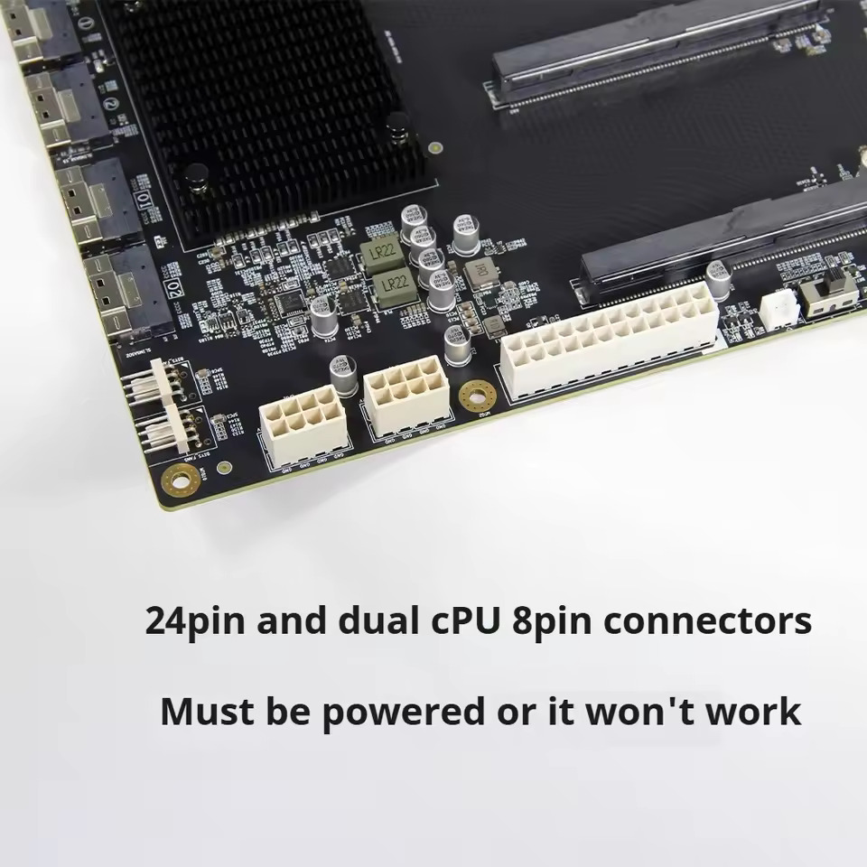

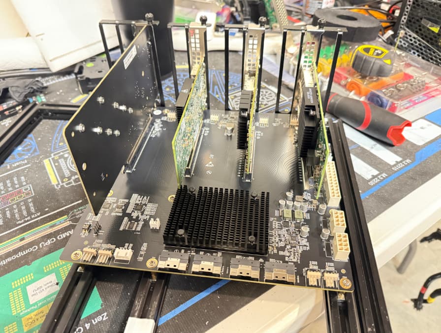

Got that Chinese gen4 pcie switch online with a bunch of junk test cards (in case it melted them or something lol)
I am enumerating the pcie topology now trying to understand what kind of 96 legged octopus this thing is under the covers, what it can do, how to monitor it, etc.
The automatic power on feature was very nice, but using a retimer with it seems mess with that feature.
EDIT: Success! Loaded 4x3090 into the card and it fired up as well:

The topology of this thing is rather interesting:
root@rome:~/llama.cpp/build/bin# nvidia-smi
Fri Oct 10 01:53:40 2025
| NVIDIA-SMI 580.95.05              Driver Version: 580.95.05      CUDA Version: 13.0     |
| GPU  Name                 Persistence-M | Bus-Id          Disp.A | Volatile Uncorr. ECC |
| Fan  Temp   Perf          Pwr:Usage/Cap |           Memory-Usage | GPU-Util  Compute M. |
|                                         |                        |               MIG M. |
|   0  NVIDIA GeForce RTX 3090        On  |   00000000:85:00.0 Off |                  N/A |
|  0%   47C    P8             25W /  350W |       1MiB /  24576MiB |      0%      Default |
|                                         |                        |                  N/A |
|   1  NVIDIA GeForce RTX 3090        On  |   00000000:88:00.0 Off |                  N/A |
|  0%   46C    P8             23W /  350W |       1MiB /  24576MiB |      0%      Default |
|                                         |                        |                  N/A |
|   2  NVIDIA GeForce RTX 3090        On  |   00000000:8C:00.0 Off |                  N/A |
| 46%   55C    P8             27W /  350W |       1MiB /  24576MiB |      0%      Default |
|                                         |                        |                  N/A |
|   3  NVIDIA GeForce RTX 3090        On  |   00000000:8D:00.0 Off |                  N/A |
| 49%   54C    P8             25W /  350W |       1MiB /  24576MiB |      0%      Default |
|                                         |                        |                  N/A |
| Processes:                                                                              |
|  GPU   GI   CI              PID   Type   Process name                        GPU Memory |
|        ID   ID                                                               Usage      |
|  No running processes found                                                             |
root@rome:~/llama.cpp/build/bin# nvidia-smi topo -m
        GPU0    GPU1    GPU2    GPU3    CPU Affinity    NUMA Affinity   GPU NUMA ID
GPU0     X      PXB     PXB     PXB     0-95    0               N/A
GPU1    PXB      X      PXB     PXB     0-95    0               N/A
GPU2    PXB     PXB      X      PIX     0-95    0               N/A
GPU3    PXB     PXB     PIX      X      0-95    0               N/A
Legend:
  X    = Self
  SYS  = Connection traversing PCIe as well as the SMP interconnect between NUMA nodes (e.g., QPI/UPI)
  NODE = Connection traversing PCIe as well as the interconnect between PCIe Host Bridges within a NUMA node
  PHB  = Connection traversing PCIe as well as a PCIe Host Bridge (typically the CPU)
  PXB  = Connection traversing multiple PCIe bridges (without traversing the PCIe Host Bridge)
  PIX  = Connection traversing at most a single PCIe bridge
  NV#  = Connection traversing a bonded set of # NVLinks
