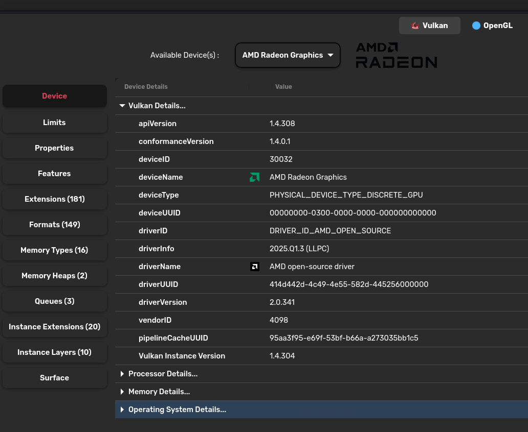

Sure, I checked. Here’s a screenshot from Gpu-Viewer:

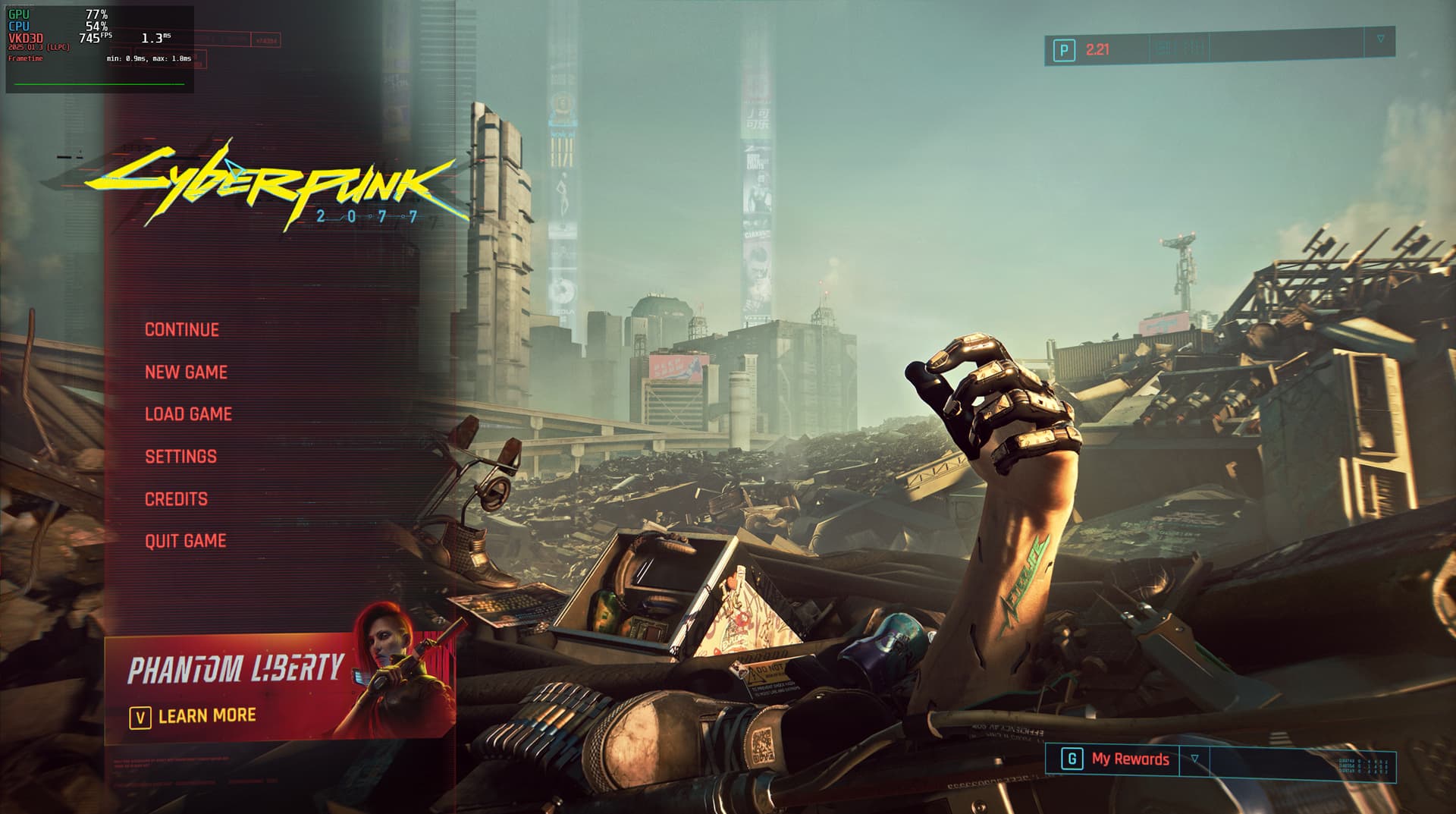

And here’s a screenshot from Cyberpunk 2077:
Interesting… So not only a RADV issue…

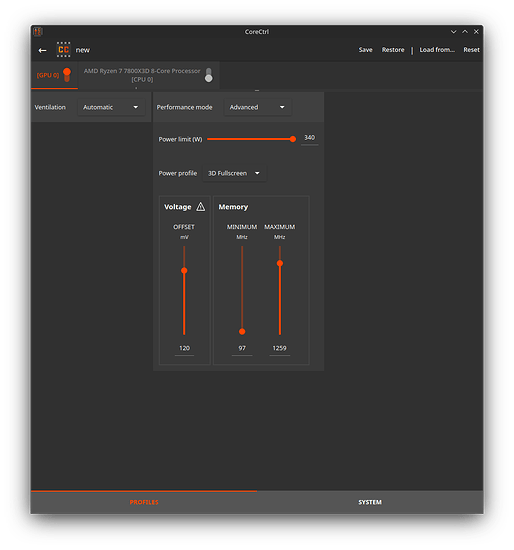

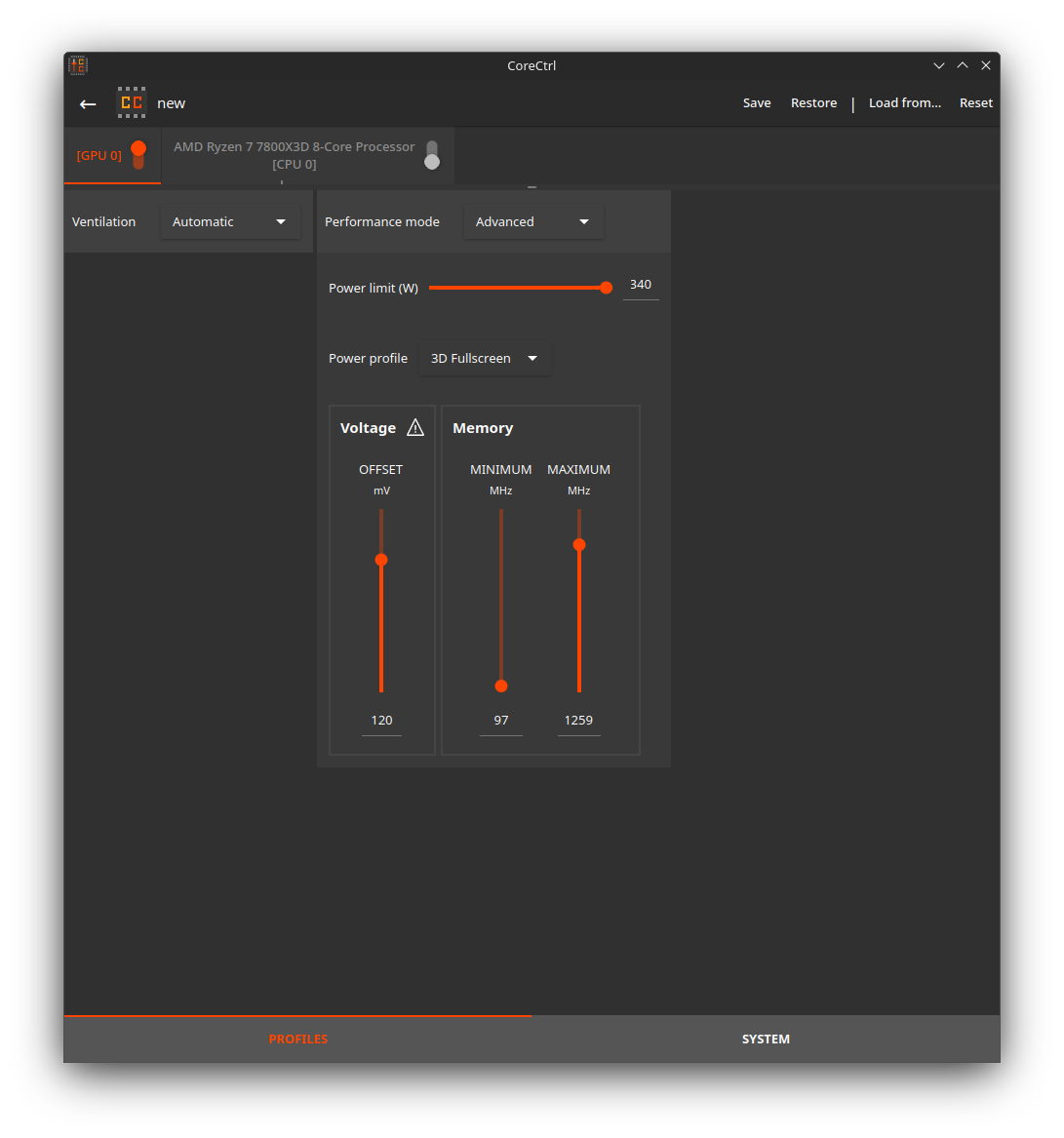

Are you guys able to get corectrl advanced options for 9070xt? I am not sure if it’s a problem with my local or lack of driver support.
Under advanced I have power limit, voltage offset and min / max memory clocks.
CoreCtrl version 1.4.3, kernel 6.13.6 and mesa 25.1.0 (git) linux-firmware-git
