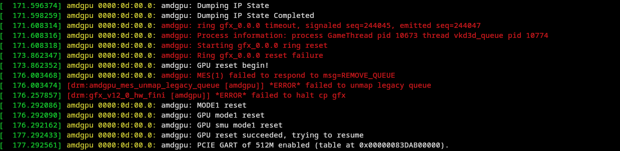

@wendell finally got around to running dmesg. Current error messages around this are in the attached screenshot
so actually for me. It turned out somehow during the install process amdgpu got blacklisted. Check your /etc/modprobe.d/blacklist.conf to see if amdgpu is in there and remove it, though someone with more sense please chime in if that wouldn’t be appropriate. In any case I actually ended up install Manjaro and just got Manjaro running with it as well tonight and luckily didn’t get that blacklist issue. Though it’s am so testing games tomorrow. Queued up a few to download overnight.

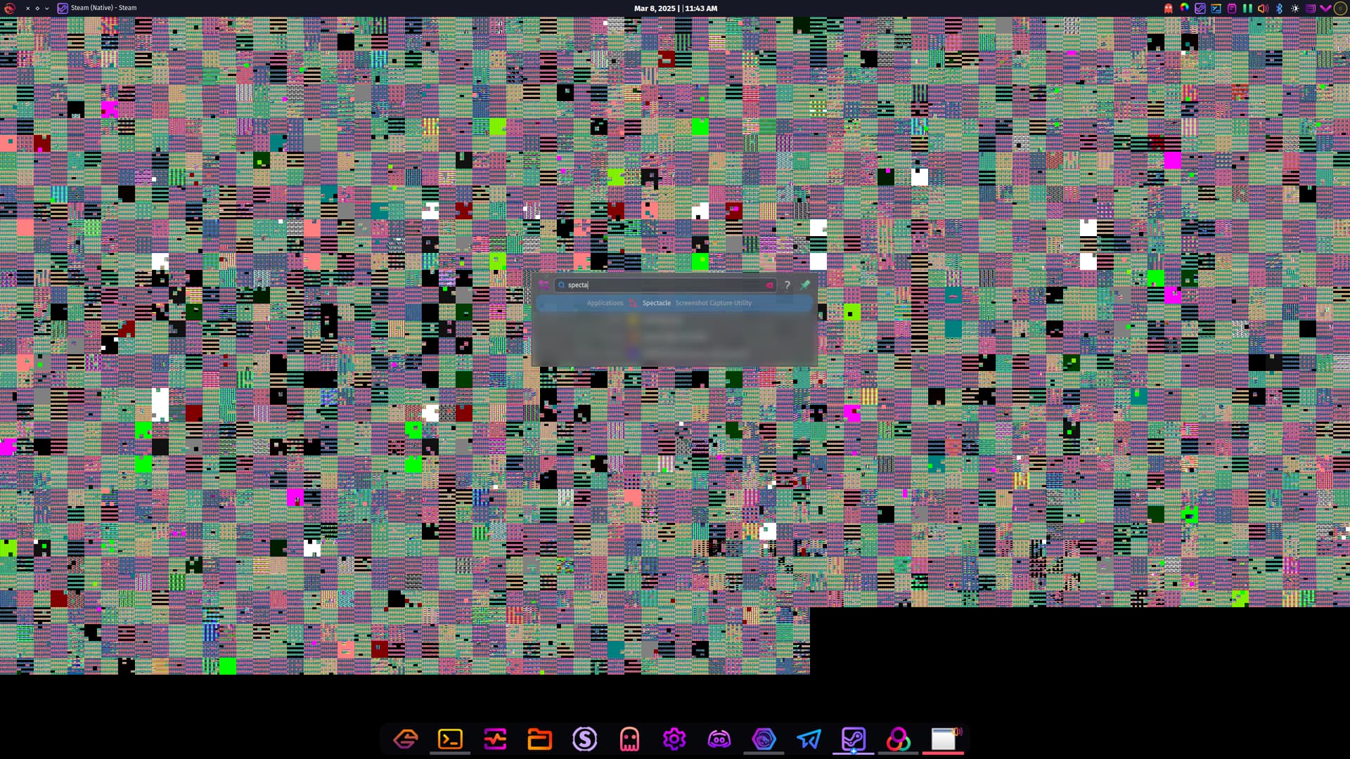

Also to note, when running it a second time after the crash messages above, screen corruption on cyberpunk is only in the borderless fullscreen window. You can see the menu bar and the quick bar at the bottom and I’m able to use the rest of the computer as normal

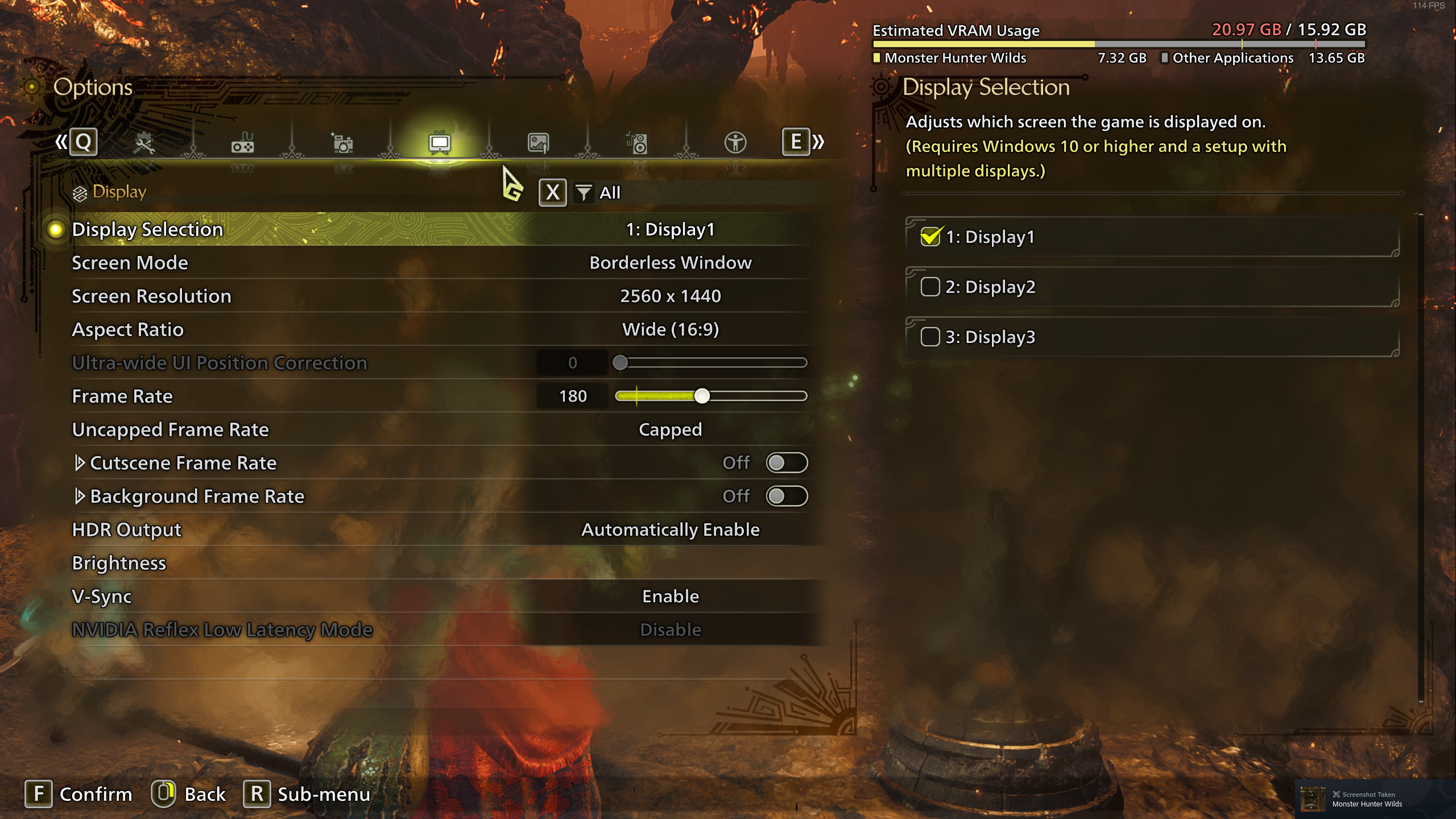

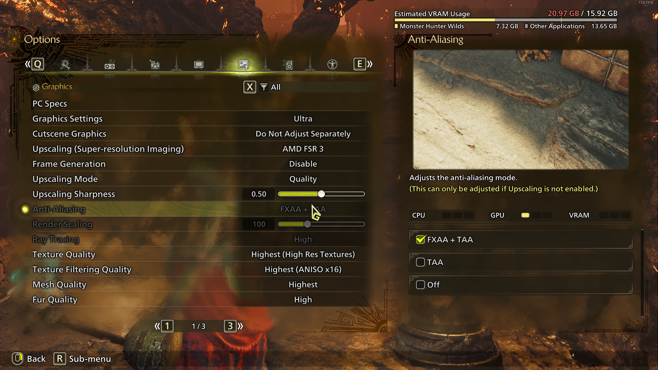

I got the chance to try Monster Hunter Wilds this morning on Proton Experimental. It launched but VRAM usage was high. Performance seems promising but haven’t tried anything other than launch. Want to confirm VRAM usage.
Your “other applications” VRAM usage is far too high. Or at least, compared to mine it is. I know Electron processes in the background can cause this. If you run nvtop what do you see?
