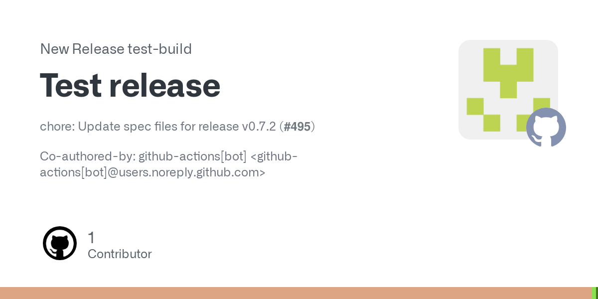

RDNA 4 Support currently out in a Test build for LACT:
EDIT: It’s now released as 0.7.2: Release v0.7.2 · ilya-zlobintsev/LACT · GitHub

Hi, I’ve published a release of LACT with support for overclocking on RDNA4: Release v0.7.2 · ilya-zlobintsev/LACT · GitHub
Yep, and so far… works without issue!
