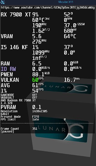

Here is how it looks
Guess i made it harder than it needs to be (Sorry) ill just upload the mangohud.conf file in pure text ready to be copy pasted. You only need to change the centered text, cpu and gpu information. All else is ready at size 90 font size. (Perfect for 4K and above) Change the font size to something smaller if you wish to. Lowest recommended for 1440p is 64 (Play around with the settings to make it suit your needs)
