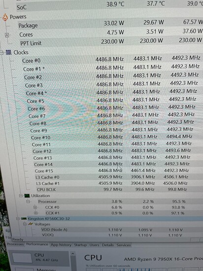

I just tried it out – disabling Core Performance Boost caps the frequency at the base frequency (4.5 GHz for a 7950x). The benchmarks from puget are a bit misleading perhaps since they are all multithreaded… On a single tread you lose a lot of performance like this… 5.5-5.7 down to 4.5 is a big gap, depending on the application. Even to 5.0-5.2 GHz multicore down to 4.5 is a pretty big dip.
IMO if the system is unstable with CPB enabled – given decent cooling etc. – the CPU should be RMA’d. Capped at 4.5 is too much of a limitation for many workloads.
Setting “Core Performance Boost” to Disabled criples my CPU by limiting it to it’s Base Clock (4.5 Ghz, see screenshot below)
When I booted BIOS for the first time this option (“Core Performance Boost”) was set to Auto (which seems to be the same as “Enabled”). If I “Load Optimized Defaults” (i.e. reset BIOS settings to “safe” defaults) it sets “Core Performance Boost” to Auto (which again seems to behave the same as Enabled and which allows CPU to run beyond Base Clock but still lower than Max. Boost Clock of “Up to 5.7 GHz” so that’s why I’m reluctant to call it OC. OC would be beyond 5.7 GHz)

My AM5 MSI B650 board does the same. Clocks are limited to base.
I checked on my own system and CBO is only offers auto or disabled options, with default being auto and no description whatsoever.
Reddit anectada matches you observation, that disabling it stops core from boosting above baseline frequency.

Yes also here auto (=default) is enabled. I would think that means it’s also AMD’s default and IMO should be stable on any non-defective CPU.

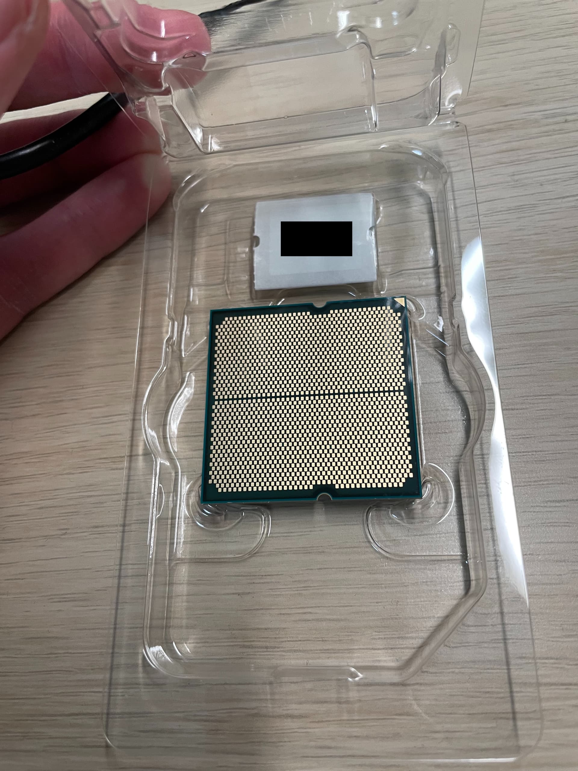

It is also possible that the CPU was not seated well, or the cooler was not evenly tightened.
You could try putting the 7950x back carefully, examining the backside beforehand for anything that could prevent good contact… But I understand if you do not want to do that.
Overtightening or undertightening the cooler can also cause issues.
Looks ok…
