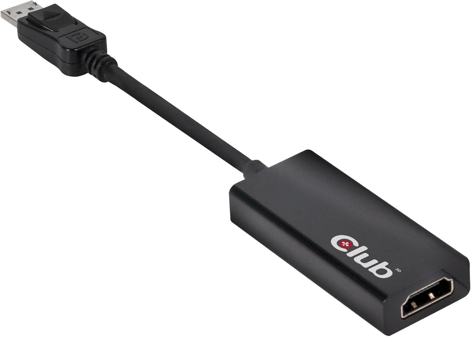

I have this GPU and just bought this TV. I am wondering if it is possible to get 4k @60Hz with this GPU with an adapter since my GPU does not have an HDMI 2.0 port.
I have yet to see anyone not have problems trying to do 4K 60Hz with a HDMI port out of a video card, nvidia or Radeon.
Use an active Displayport to HDMI adapter. I highly suggest Club 3D as not all are created equal and Club 3D is tried and true, I use 3.

The 290X nor the Fury had HDMI 2.0. I had to buy an active display port to HDMI 2.0 to finally get 2160P 60Hz from my Fury.
It was able to display from its own HDMI but only did 30Hz with lots graphical glitches that also cut the audio.
I purchased this one
Old topic but I found it while searching the google machine. I am trying to get this working on a Fury X to no avail. I got 4k 60p 4:4:4 working on intel hd 630 on my 8700k with the club3d active adapter but it doesnt seem to want to take on my Fury X or another machine with a 290x. :frowning:
