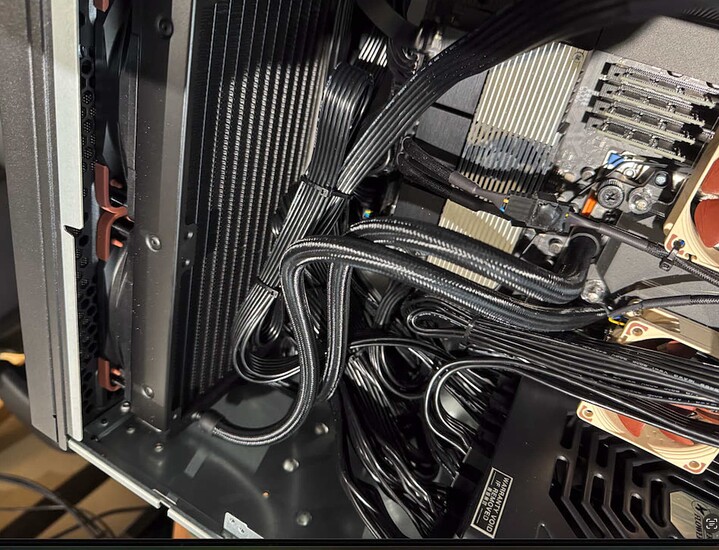

This is not exactly my build - I mean I own it, but I did not build it. It was purchased from a pretty well-known SI who shall remain nameless - but if you’re in North America you probably know of these guys. They have been around for a long time, solid reputation, pricey but very solid builds. This isn’t a “got fucked over on craigslist” post. And the price is not a typo.
For that though I’d have expected a little more… craftsmanship.
Rack case, removed top - greeted by cables.

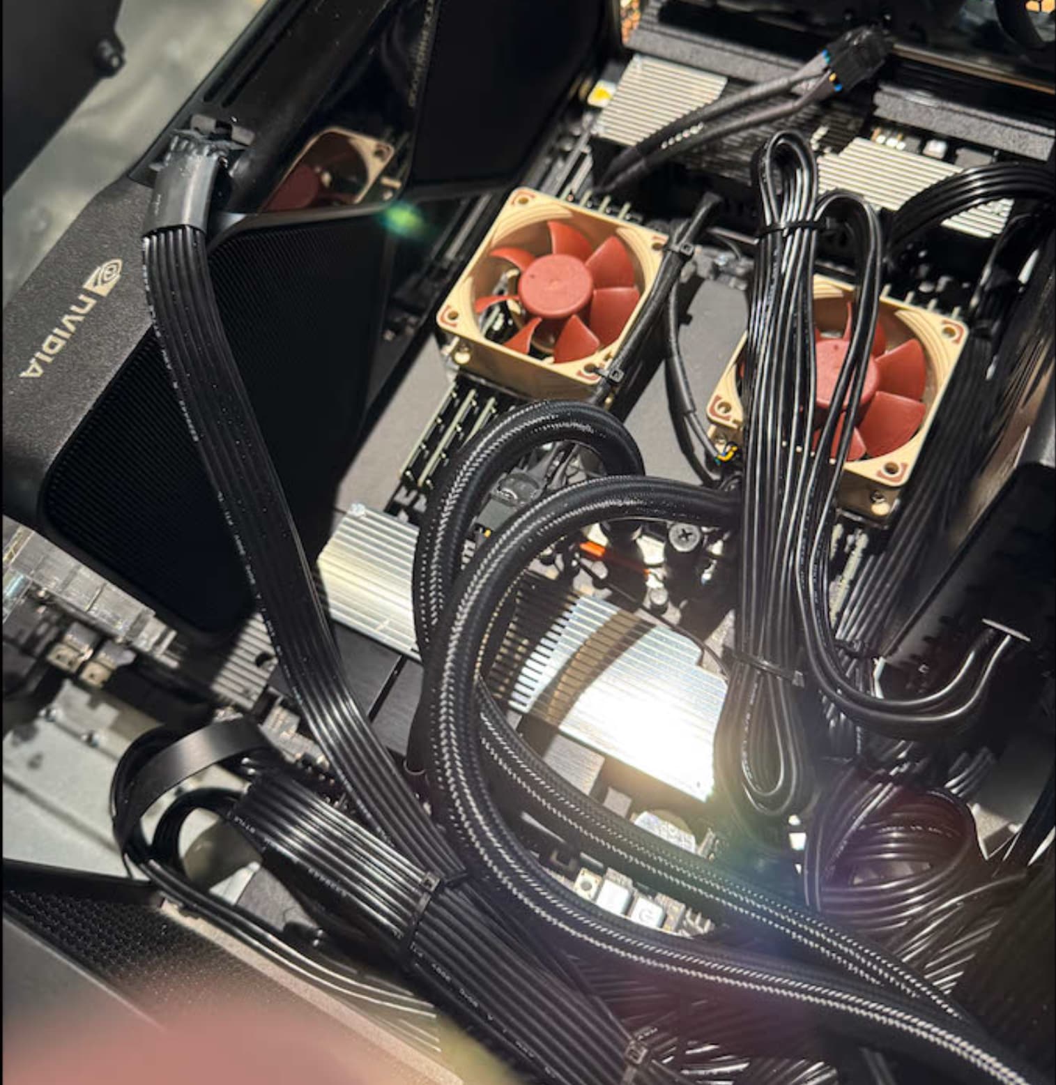

That bundle is just casually laid on the 60mm fan. Doesn’t quite touch the blades so I guess it’s whatever.
The AIO doubles as cable-cooler. There’s high amps in here, you never can be too careful.

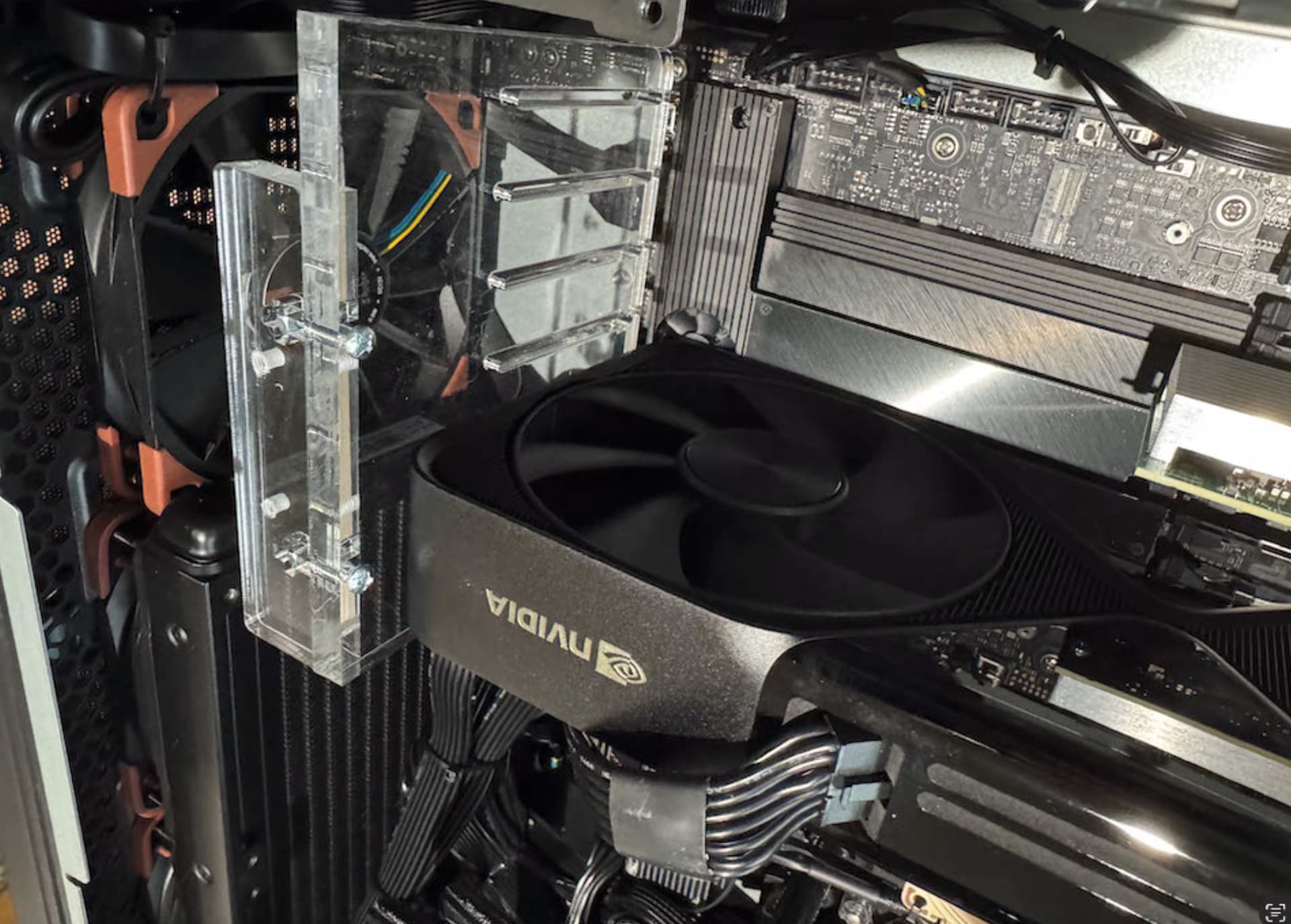

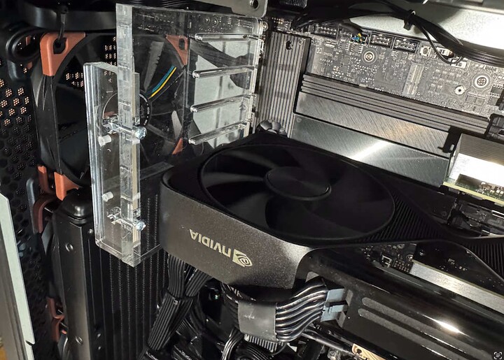

Bracket to hold the gpu and… block all air from the only soure nearby? Here I am genuinely puzzled, maybe the GPU is supposed to pull air in from the back of the case through the bracket grilles by sheer negative pressure?
Gotta be.

I would take pictures/video before, then cable tidy, then after, and send them to the S.I.
For that money, it might be worth them taking more care for customers, and I bet it was just a couple guys taking shortcuts, rather than the whole company.
Pretty sure a “call in to the managers office” would correct the attitude of the person who should have done the build.
But, I would not loudly shout it, else the lazy person, might just get fired, and that may be excessive.
As for the plastic air blocking shroud… If it was inserted for shipping stability, it really should have been marked as so, and does seem more intentionally like it is supposed to be there I would also reach out to SI, and ask what its purpose is, and the reasoning of shaping air flow around that way, if any

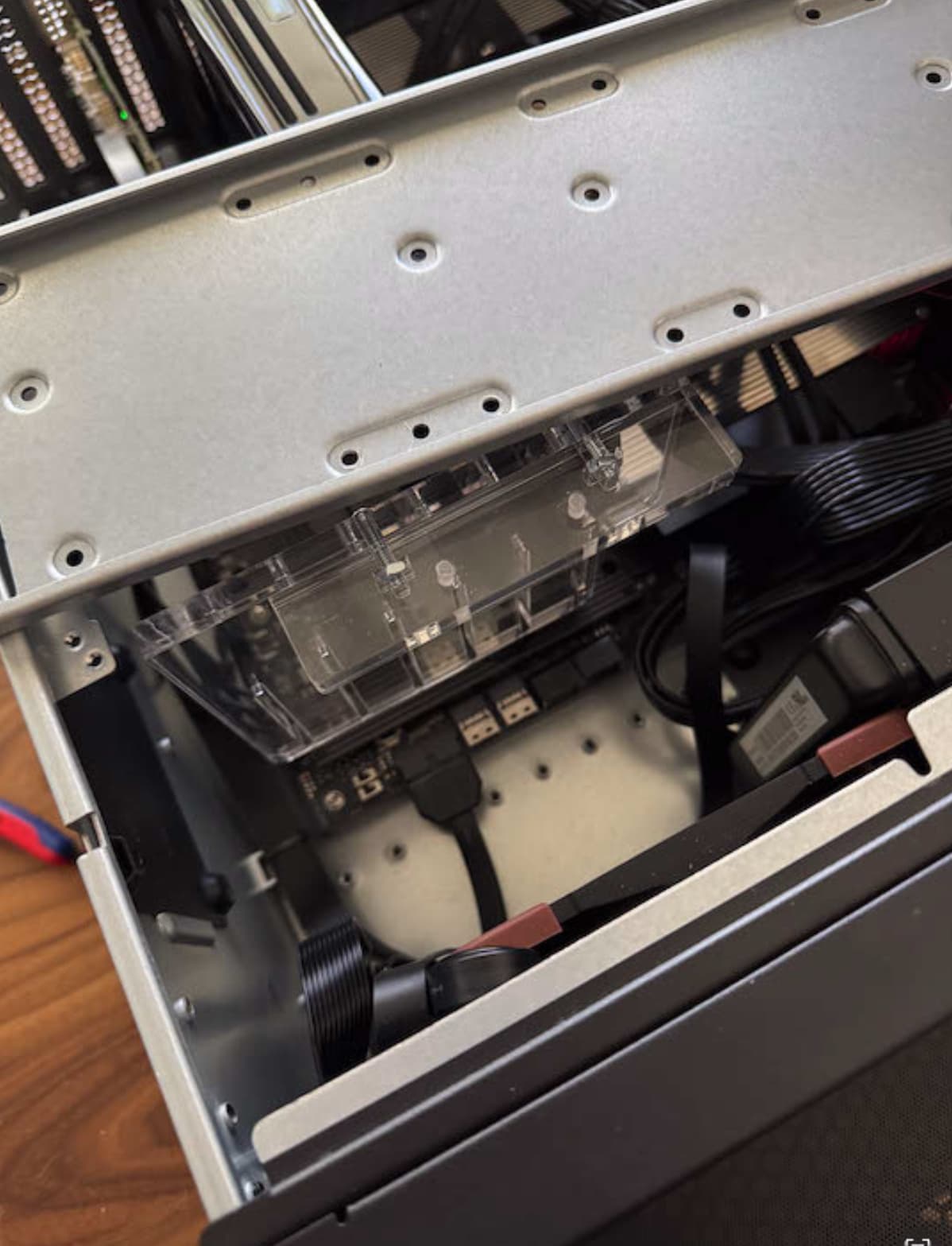

The acrylic GPU bracket is meant to be permanent. They used to do temporary shipping fixtures with giant “REMOVE BEFORE USE” stickers, and transitioned to these permanent ones a number of years ago. Anything heavy inside like big cards or large air coolers get a custom-made piece of plastic, and they aren’t skiddish about drilling M4 holes into GPU plastic frames if they have to. It’s usually very strong, secure, and never in the way. I really am confused about what they did here.
And yeah the cabling’s getting fixed. The only question is, am I stocking up on genuine Molex MiniFit Jr. crimping parts and doing it myself, or am I ordering “roughly OK length” knockoff cables from China.
I was implying nothing more than cable-ties.
If you need actual cables (like longer ones to fit/route properly), then I would email them and get them to mail them to you free of charge.
It has been many years since I brought a system, and that was cabled tidily for less than a 20th of your price…
Sad to see a company worsen, whatever company it is…

That GPU bracket is something else.
I don’t imagine it’d be that easy design a bracket for that particular use case, that still allowed plenty of airflow… at least not one that was still as strong or made out of acrylic but there must have been a better solution, surely?
It really is a small case and there’s no room to put all that excess. Without custom cables it’s going to be an eyesore no matter what. But the weird thing is that these guys stick to one PSU vendor, so I am sure they could get factory cables in any length they wanted.

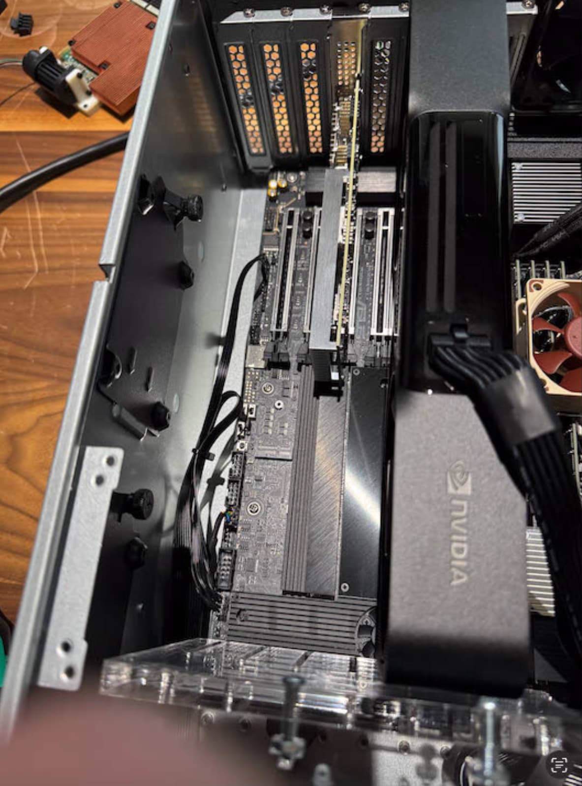

The OP photos didn’t show the PCI retainer that 3U+ cases have. I removed it because it was hiding most of the cabling mess. They bolt the acrylic to the GPU and this retainer. It’s simple and effective. The plastic piece just doesn’t have to be this wide; it looks like it’s meant to hold block air from two GPUs.

One more nit I found after I got into IPMI: all the fan curves look reasonable but they’re all tied to CPU temp. Even the RAM fans. Like, you’re going through all this trouble (sturdy fan mount custom made to sit on the CPU block and hold 60mm fans in the right spot) and you’re not using DRAM temp sensor readouts for them… why. Maybe because ASUS BMC gives you per-slot DIMM readings and no aggreggate, but I’m really grasping for excuses here.
