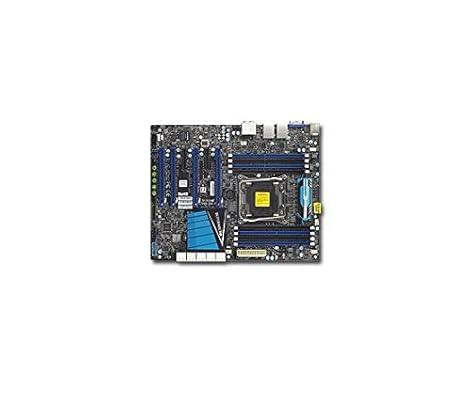

A good board to go with the Xeon would be this:
if he's spending 2k let him take dual cpu mobo for ~$500 // just fyi EEATX is hard to find mobo tray.

http://www.ebay.com/itm/Supermicro-Motherboard-MBD-X9DRL-IF-B-LGA2011-Mainboard-for-Dual-processor-DDR3-/121857145046?hash=item1c5f4078d6:g:izkAAOSwYIhWi2Wa
2x
http://www.ebay.com/itm/SR0KX-INTEL-XEON-E5-2670-8-CORE-2-60GHz-20M-8GT-s-115W-PROCESSOR-CPU-/131712879364?hash=item1eaab30b04:g:DKkAAOSwPv9XMLx9
