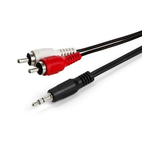

Why can't you use a 3.5mm out?
Because I don't have a 3.5mm input in my receiver.
I don`t know of a real receiver without one what in the world are you plugging into

Quickest and easiest fix that I can see:
http://www.amazon.com/RiteAV-Feet-3-5mm-Stereo-Cable/dp/B000V0G2C4
RiteAV 6 Feet 3.5mm to Stereo RCA Male Cable

So you're suggesting to use a 4 speaker setup just in stereo? FYI, my original question was whether or not it's possible to use HDMI just for audio while a second HDMI (or DisplayPort) port would be used for video not how to efficiently degrade the sound ;)
