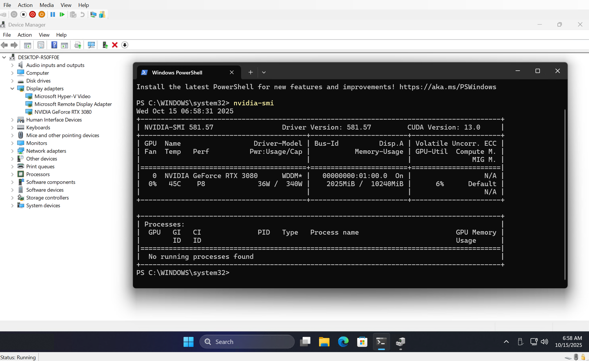

Hello, funk192, your post is what I was looking for so many days or weeks and I’d like to know how to install Nvidia driver directly to the Hyper V vm.
How do you spoof VM? Should I copy this " Computer\HKEY_LOCAL_MACHINE\SYSTEM\ControlSet001\Enum\PCI"?
Also which drivers ( there are a few drivers (.inf) files in nvidia folder) need to be copied into hostDriverStore?
how to restart both NVContainerLocalSystem and NVDisplay.ContainerlocalSystem services? I am not sure they are excutable.
Could you explain the whole process step by step, please? I will really appreciate it.
Device manager shows my graphic card ID details of this following: PCI\VEN_10DE&DEV_2C05&SUBSYS_53101462&REV_A1
PCI\VEN_10DE&DEV_2C05&CC_030000
Which one is device ID among these numbers? Thanks in advance
