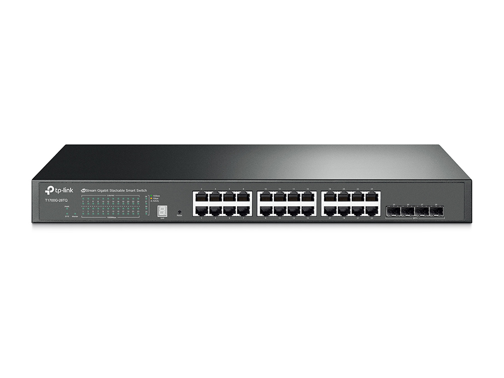

The low end one of these four is fanless and would combine gigabit and 10G in one device. I’m looking for the catch but haven’t found one yet. Am I missing something?
Only four 10G ports the rest is 1G and you still need to buy 4x SPF+/RJ45. I thought you needed more than 4 10G ports. But if you only need 4x 10G …
So we’re doing a 180-degree turnover on the requirements …
4x 10G SPF+. 24x 1G RJ45.
TP-LINK T1700G-28TQ (V3) and 4x SPF+ 10GBase-T Transceiver…
https://www.tp-link.com/us/business-networking/smart-switch/t1700g-28tq/
Fanless Design for Silent Operation
The T1700G-28TQ utilizes a fanless design, which reduces the amount of ambient noise in your office. Removing the fan also reduces power consumption and helps you build a more cost-effective network.
Pros: Inexpensive, seems solid, 4 x 10GbE SFP+ uplinks, quiet (fanless), has readable documentation, does what I need.
Cons: Web interface is a tad clumsy, not fully intuitive. I couldn’t get some features like AAA radius authentication to function as expected, though everything seems to be entered correctly. Same backend works fine for my wireless access points. I packet sniffed the link to the radius server and it appears the switch isn’t even trying to talk to it. Be prepared to do some trial-n-error with this device if you want to do more with it than basic switching.
Overall Review: There are two versions of this switch, mine came as a V1 with the 1.0.2 image installed. I did manage to find the 1.0.3 firmware on the Canadian web portal. No firmware available on the US web portal–a little disconcerting.
Bottom line… If you need 10GbE uplinks (more than two) on a budget, this unit may fit the bill. I haven’t pushed this device real hard yet, so it may have some performance issues I’m yet to discover. So far, so good. I have three 10GbE servers connected to it with about a dozen 1GbE clients and all is well. It would be nice to have all the fancy features work out-of-the-box, but it appears this may take more work and most of those features are just nice-to-have but not critical. Basic switching does seem to work fine.
I recommend this switch simply for the price if you need the four 10GbE ports. You can spend a lot more for just that with other brands. If you can live with only 2 10GbE ports, you have other options for this price range.
The main feature of this switch is being able to stack them. I wasn’t looking for this feature as 24 1GbE ports is gobs for my small lab. With that in mind, I can’t say anything about having multiples of this switch connected together. It may work; it may not. I do know this switch works standalone as advertised.

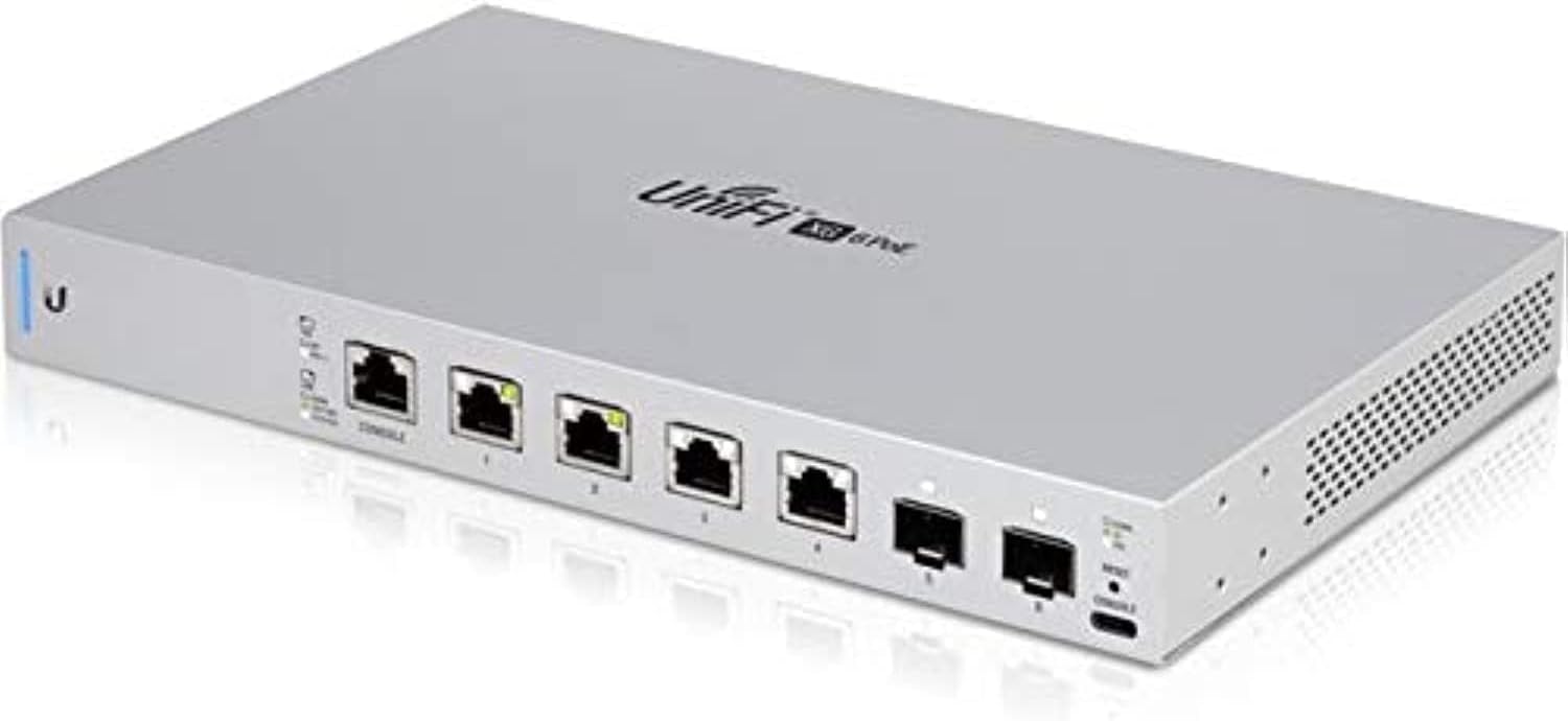

Maybe look at US-XG-6POE …
(4) 100 Mbps or 1/2.5/5/10G RJ45 Ports
(2) 1/10G SFP+ Ethernet Ports
Wish they made an Edgemax version of those without POE for <$400.
With that one I would still have to use a secondary switch for my gigabit stuff. The TP-Link and Zyxel ones would be a one stop solution. Also those are a lot less money, even with four SFP+ to RJ45 doodads.
I think the TP-Link is worth a shot. That plus two adapters is about 350,- bucks.
With that I can check throughput and decide.
It looks like this tplink will be closest to your needs and the cheapest. That 8 port mikrotik is also cheap but after adding modules and the fact that you would have a bottleneck between the new and the old switch will not make sense, so tplink will be a better choice for the moment, unless a better offer is found.
