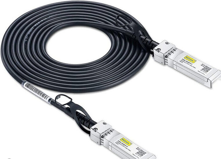

if you dont want to go in to many problems and details and your conections are close, get a cable.

  4. For runs under 15ft (5m), Direct Attach Cable can work. Mind you some switches are little princesses that want their DAC not some random DAC.

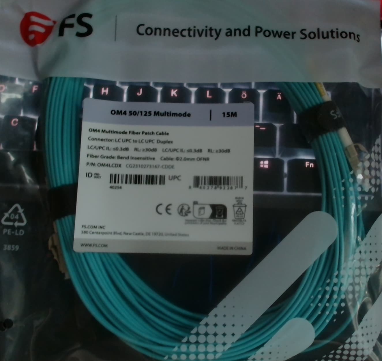

I tried to follow the reddit guide and I think these should work together. Any thoughts?
Those work fine. (edit, just noticed the cable end. You need LC on both ends. I would get an OM4 cable though since the price difference is $5, ands OM4 will support up to 100-200gb and last you “basically forever” in a home environment.
If your distance is an estimated 30-40ft, then get a cable 40-50ft long. Always better to have a little loop of extra at an end to be able to move it a little.
https://www.fs.com/products/40251.html?attribute=803&id=18482
That cable does not have LC on both ends.
This is the version you would want:
I assume this is the OM4 15m variant?
https://www.fs.com/products/40254.html
Again, thank you so much for all of your help.
Yup, that is the one :smiley:
