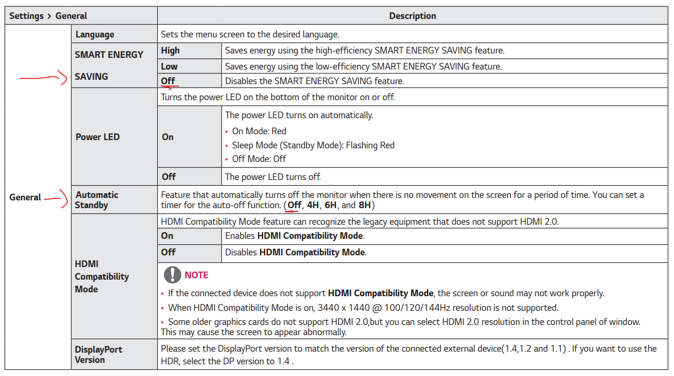

GPU on input 1 is a Radeon Pro WX 4100 (Polaris)
Connected monitor is an LG 34GK950F
Any deep sleep/eco/power saver settings on this monitor we can try turning off?
What’s the GPU on input 2? Also I’d recommend updating GPU drivers.
Will try with the standby stuff off. Input 2 is an M4 Mac Mini. I’m running the latest drivers, 6.13.8-200.fc41.x86_64 ATM.
