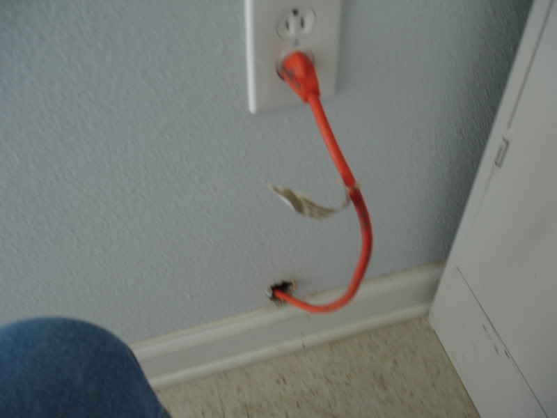

There is a cheaper solution if you’re bold enough…
